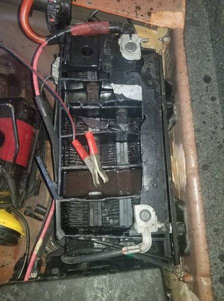

Why guys are killing them is from leaving them on a charger whether they're lead acid or AGM's. Lead acid, sooner or later you're going to boil it out enough to form a really good gas container and they make a really good hydrogen bomb. AGM's like to be partially discharged and then recharged at a high voltage of about 14.6 volts. If you ever wonder why your car burned up when you weren't home.... my buddy that thought leaving a tender on his Challenger this winter was a good idea!
