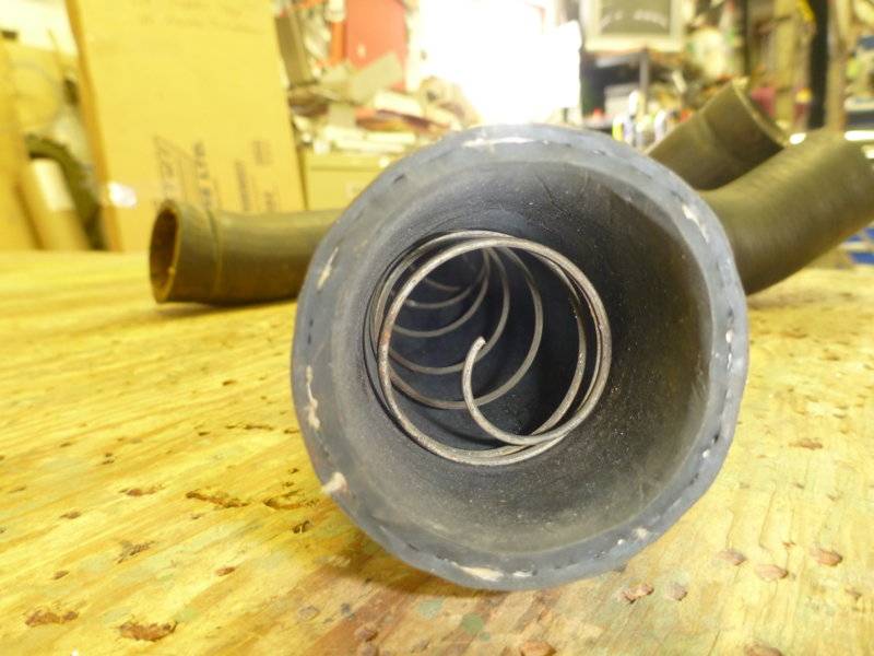

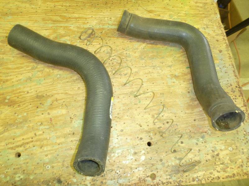

Bottom radiator hose...spring in there???

Squeeze your pump intake hose (lower rad hose). Spring inside??? New crap may not come with one, I stole my old spring and moved it over to the new.

It doesn't have a fan clutch. Belt is tight. Idling and using a digital gun at he radiator and the thermostat housing it will get up to 220+. Both hoses have springs in them. Only time it's an issue is in 90+ weather and cruising 15-20 minutes at 25-30 mph. Don't know anything about the water pump or impeller. Thought about replacing it but I hate to throw parts and hope.
