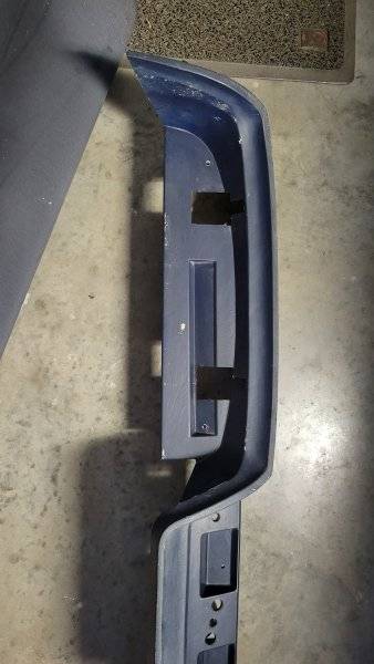

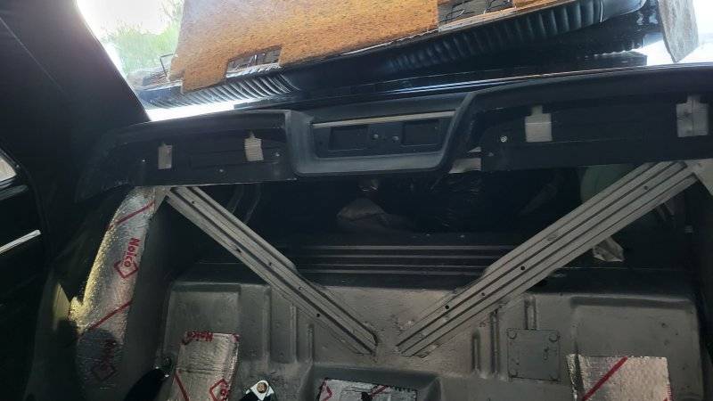

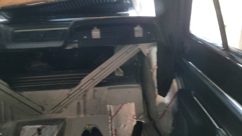

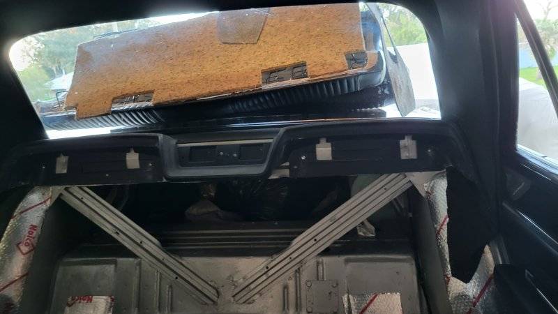

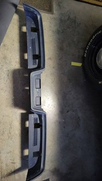

Mocked up the rear seat surround in my 67 plymouth belvedere 2. I had to do some tweaking ( nothing major) to make it fit. Yes, it's a four door. I just have to get the hooks.
I would have thought the hooks would be universally mounted for the seat back in all body styles. Do you remove the sedan ones?

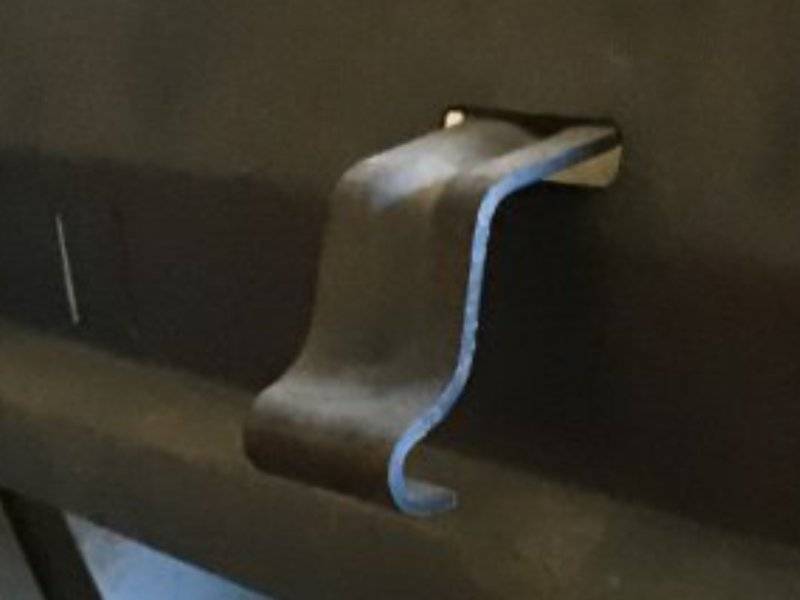

Yes, I had to remove the two hooks for the sedan. They interfered with the seat surround. I believe the hooks are the same. The GTX hooks are probably the same as the belvedere, but they are inverted. I had to do a little tweaking to the surround but, nothing major. I will have to look for the lower mounting braces for the lower part of the upper rear seat. The hooks came off easy. I took pliers and moved them back, and forth, and they broke off clean. I will remove the surround, and shoot it with SEM trim black. It was not difficult to pull this off.

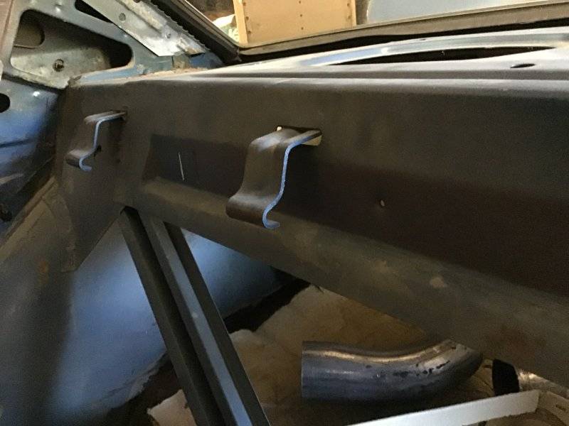

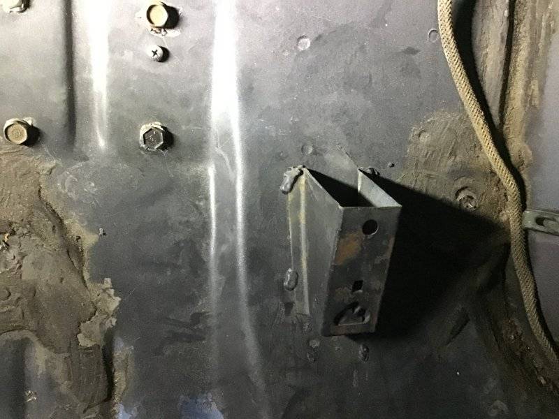

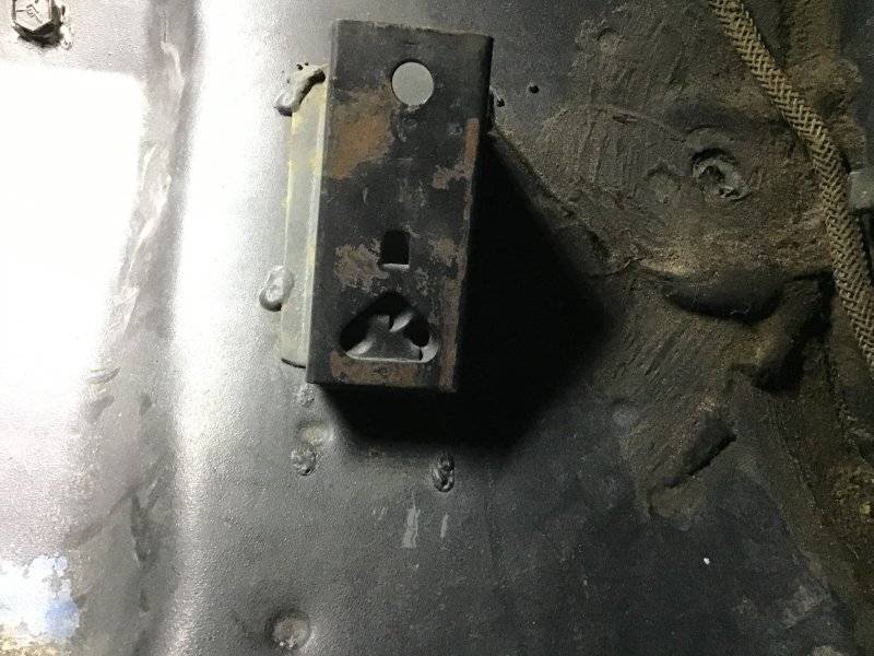

The GTX / Satellite takes completely different mounting brackets for the seat back than Belvederes. Here is a photo of a 1967.
1966 brackets are narrower, and so are the holes on the plastic seat surround. Yet another part that is different 66 to 67.
1967 Satellite also

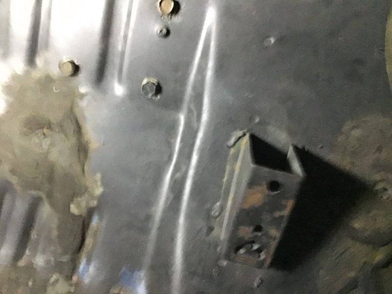

Could you show me the lower seat mounts for the rear upper seat for a 67 GTX, 66, 67 Satellite?

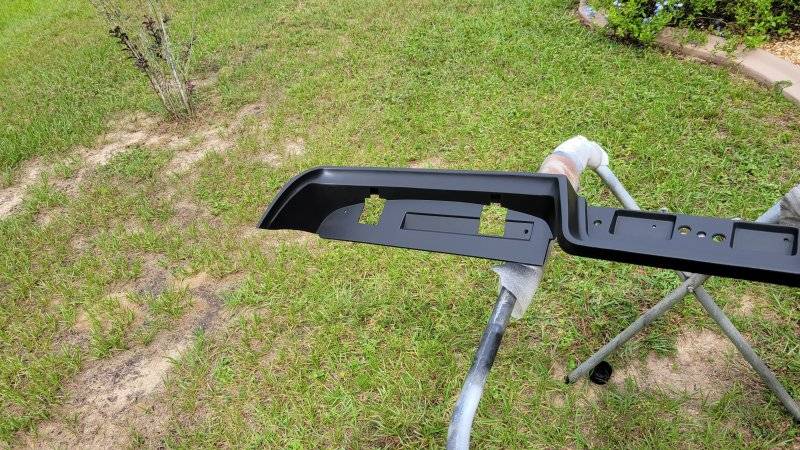

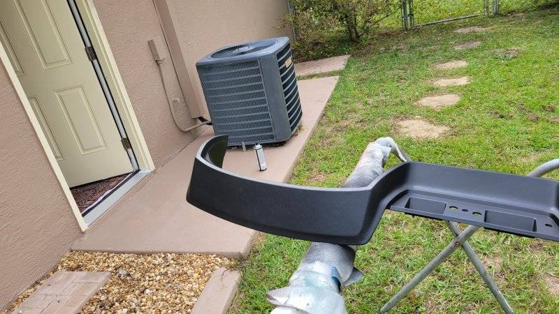

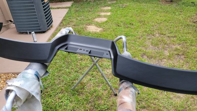

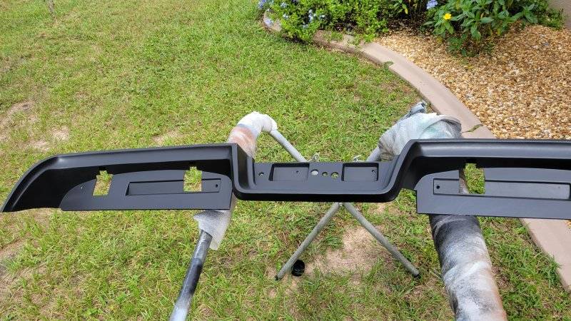

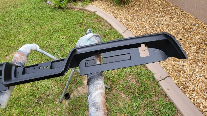

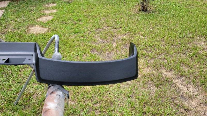

Sprayed the seat surround today. Sprayed a prep solvent then painted it SEM trim black. It's boring waiting for IAN.
If i do another one of these seat conversions, stephens performance sent me the seat mounting brackets, and the seat hooks. I now have an extra set of hooks, and i removed them from the panel using a spot weld cutter. I trimmed up some of the panel remnants, now i have perfect templates to cut the holes for the hooks next time i do this. Plus i have the floor shift template too, no guess work figuring where the console brackets go.
