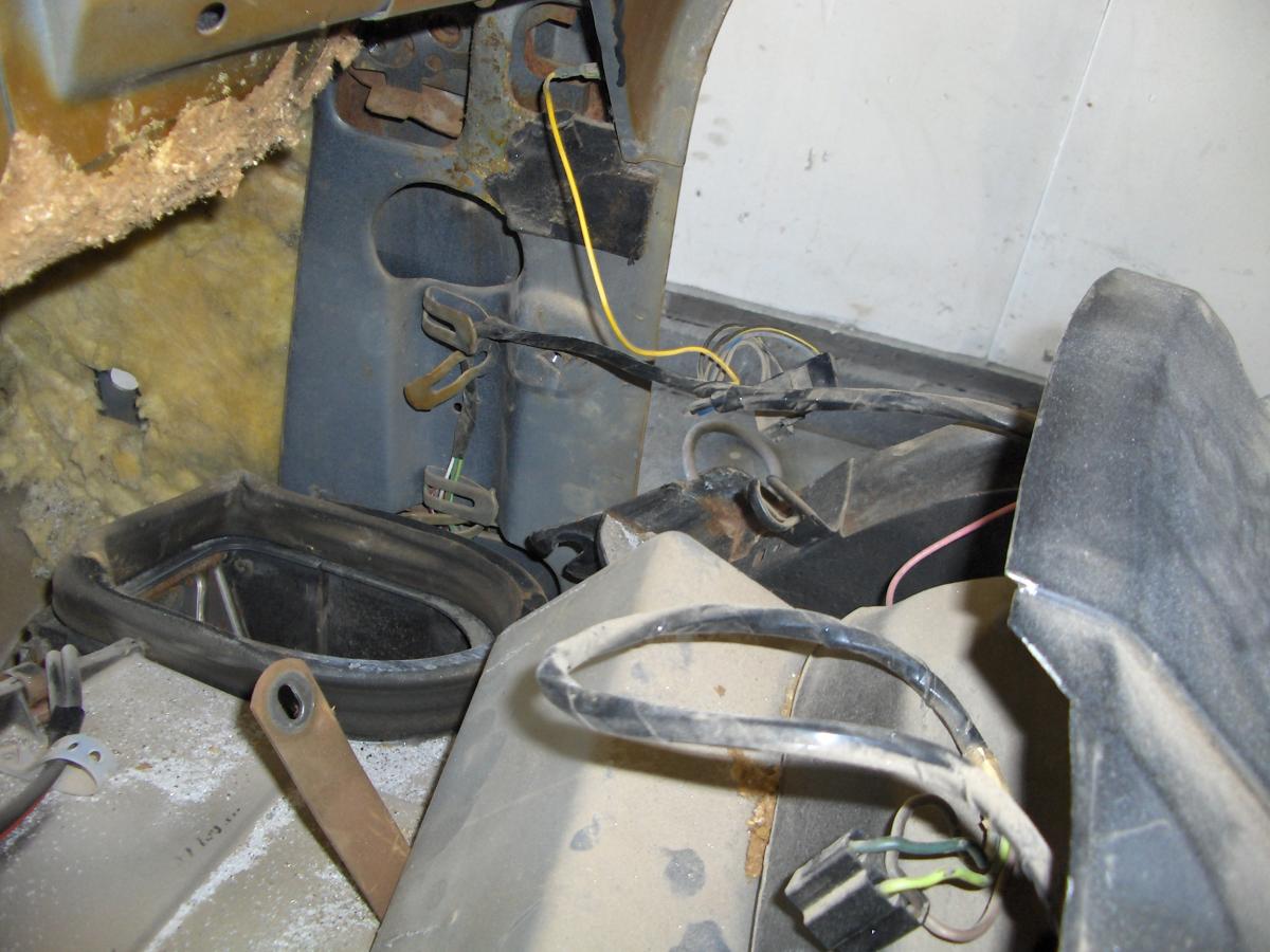

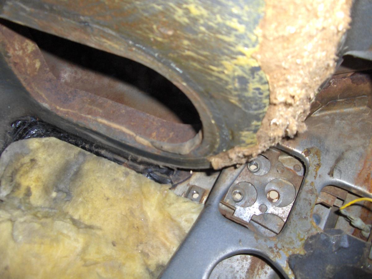

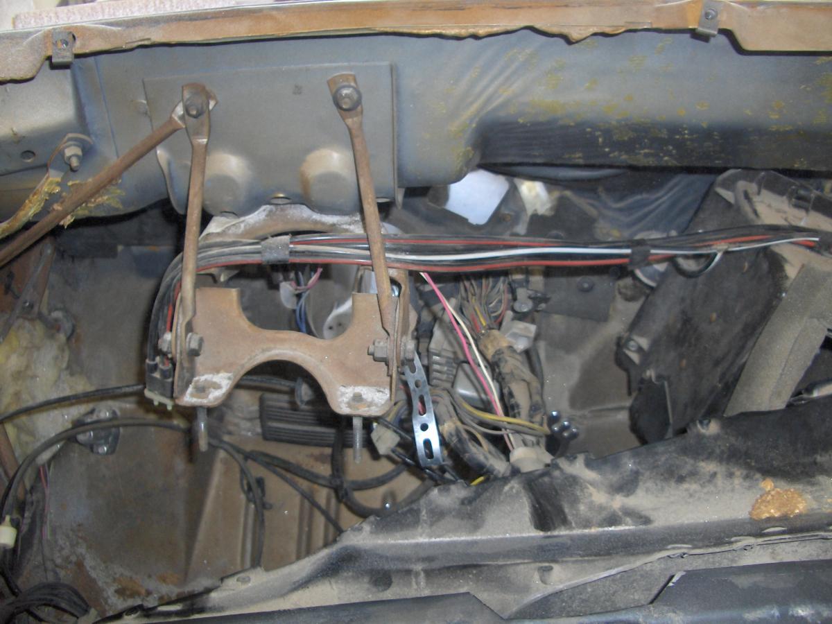

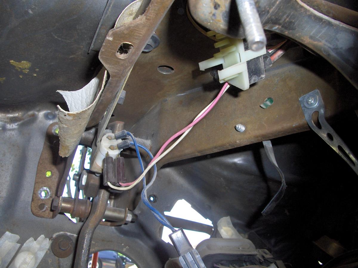

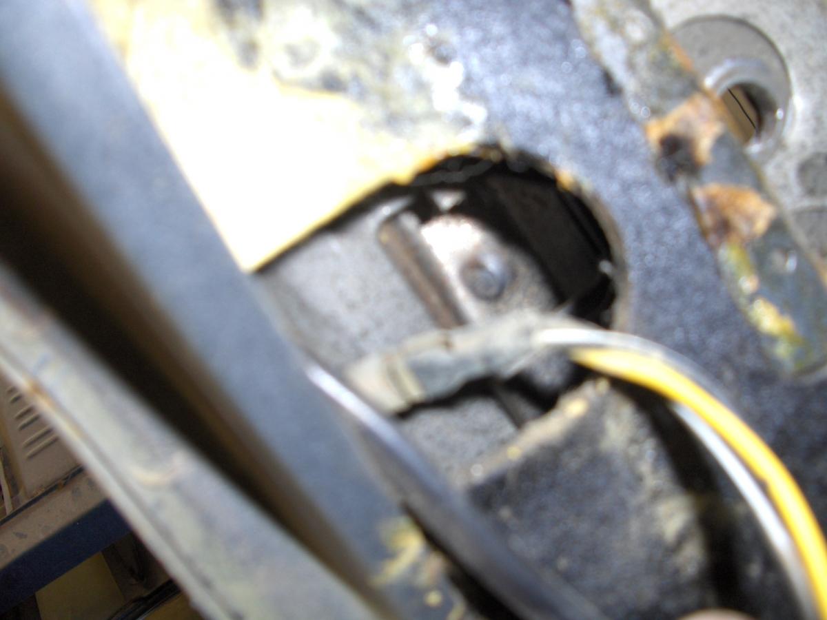

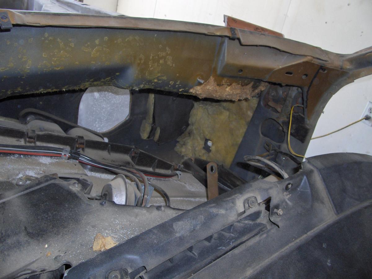

Thanks sundance, I took a look at er today. and I took a closer look underneath the dash, and it looks to have a bad quality paintjob. How hard would it be to take the whole thing out and redo it right? It's been a thing ive wanted to get done, although I find electrical stuff so technical and confusing. It's either I do it, or get charged an arm and a leg by a shop..

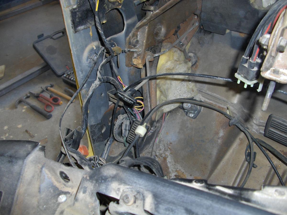

It's not bad...You can't really mess it up because all the wires/lights that go into the back of the cluster have the colors marked on it to tell you what go's where.Take lots of pic's before and during your tear down and if and when all else fails ask us :)
Here are a few pic's I tried to find for some other members.I found them by accedent today while looking for another pic of a dash lol.
