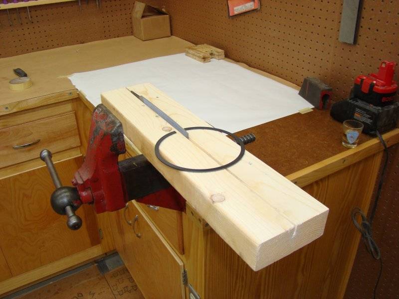

This is what I do. Works surprisingly well. Cost me nothing

For hand files, spend a bit more to get an old us made one or get a chineseium one with a new disc on Amazon?
I'd say hand file the rings if you are only doing this engine.
A key thing is to file in one direction only, moving the file always towards the center of the circle of the ring. Never pull out from the center of the circle. Why? If you file the other direction you will create a ridge that will scrape your cylinder wall. Yes, you can file away that ridge but then you reduce the contact patch of the ring.
Also, after a little bit of filing, force the ring ends together and look at them against a light source. They need to stay parallel. If they are not, fix it as you file.
Hope that makes some sense. Good luck!
