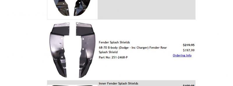

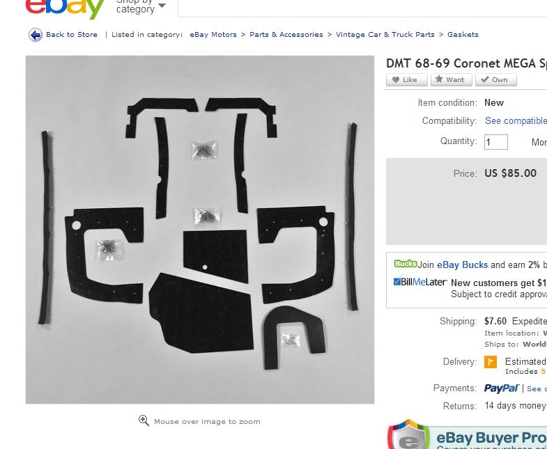

Mitch is right...Also, be sure you install your splash shields and both gaskets as well, that bolt in behind the front wheel (in front of the door jams).
Splash Shields:
http://www.521restorations.com/index.pl?page=bbody&sub1=Fender
Upper/lower gaskets as well as others for the fender/inner fender area of your car:
http://www.ebay.com/itm/DMT-68-69-Coronet-MEGA-Splash-Shield-Set-Kit-Seals-/360401556079?pt=Vintage_Car_Truck_Parts_Accessories&vxp=mtr&hash=item53e99b526f
good luck
Are the splash shields plastic or metal? I think they are plalstic for some reason.

I just ordered.

My splash pans are ok... But new ones look soooooo good... Clean mine and paint or order new?
Factory stuff is always better quality and fit then the repop stuff. If yours are decent, clean them up and save a couple hundred bucks in the process. My 2 cents..
X2. Definitely use the originals if you can - much nicer fitting. I wouldn't think yours were rusted or damaged judging by the rest of the car.
+1 on cleaning the old ones up.

Do they spalsh shields remain black or do they get color? I dound my spalsh shields.. I had already sand blasted, primed and painted semi gloss black...
So they need hemi Orange or remain black?
I'm pretty sure they get flat black - that's how I'm doing mine anyway.
