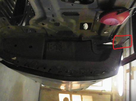

1. Make sure you don't cut the door jamb mounted braces off the front

I don't understand #1, can you clarify please?.
Thanks
Yes, surely. Well on Dodge Chargers, at least in 1969 they built the door frame from the rockers and it was the same as the inner-quarter, correct? Well the factory needed a guide to aid them with panel fitment and a thick brace to weld the quarter to. Unfortunately when my body guy cut off my quarters he cut off the brace.
I was there with him and he appologized but there's pretty much nothing to do.
This is the explaination I can offer to the best of my abilities.
Inside red square on pic, sorry that it is a bad angle.
Got it, thanks!:grin:

That brace I cut off too, by mistake! OOps! Kept the brace's though, will weld them back on the way they were.
