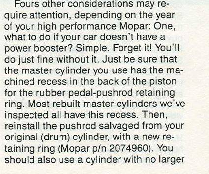

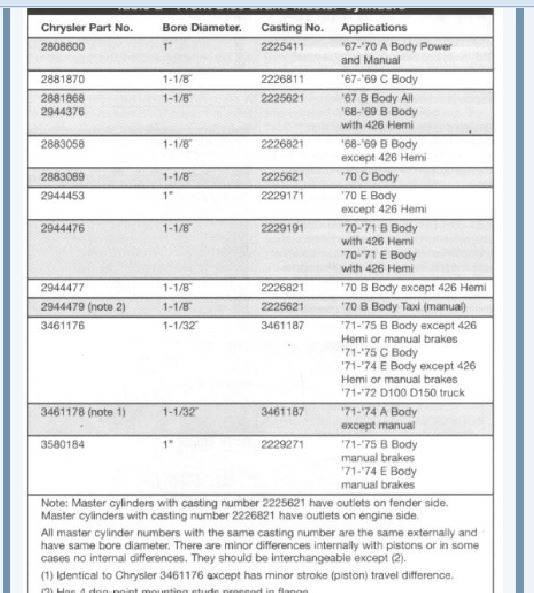

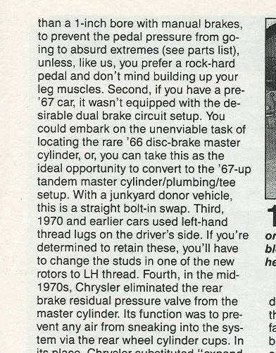

While your removing LL I'd look for a 67 or later master and replace yours. Look for master goes what you have power or manual. I converted my 66 Satellite to a dual master, bought 67 power dual master added later front/rear junction. The pictures are from a Mopar Action disc brake swap, note what he said about master bore size. I did the swap and brakes work great.
View attachment 824211 View attachment 824212 View attachment 824213

As far as I know, the current MC bore is 1-1/32" where as my older MC was 1"
It was suggested that I run that bore size for a four wheel drum setup. Perhaps I need to go to a 1" once again.
As far as wheel cylinders, I didn't know that there are different piston cylinder diameter sizes. Is that correct? Maybe that is the problem.
You need to get a 1" MC again. That 1 1/32" MC will give you a higher and much harder pedal. A MC for a manual drum brake 67-69 B Body should be what you need.
