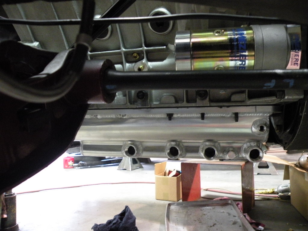

i found the picture with the starter installed.
keep in mind that the meizere is also bigger.
we had one and had nothing but trouble with it, broke off some ring gear teeth. But sounds like SSR has had better luck.
