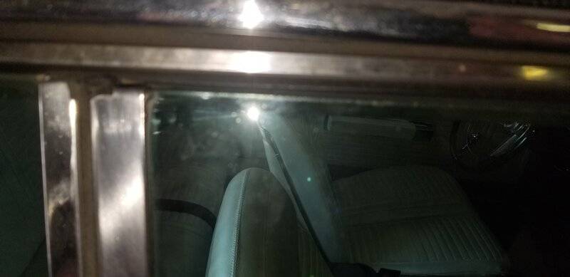

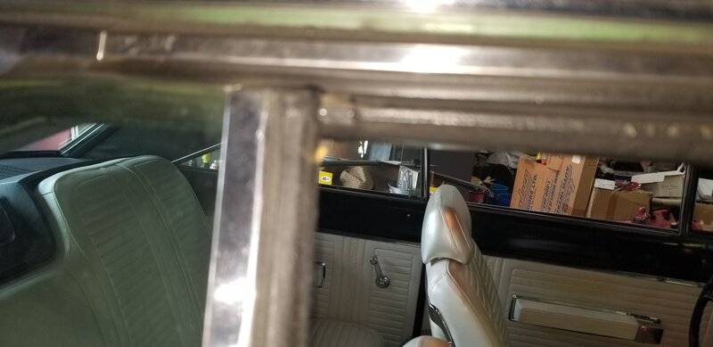

Nothing in a grove, front or back. The glass lays up beside the seal. Pictures from an original car and although the roof rail seals could use replacement, there are no air or water leaks.
Thanks Jerry, that’s a vote for door #1.

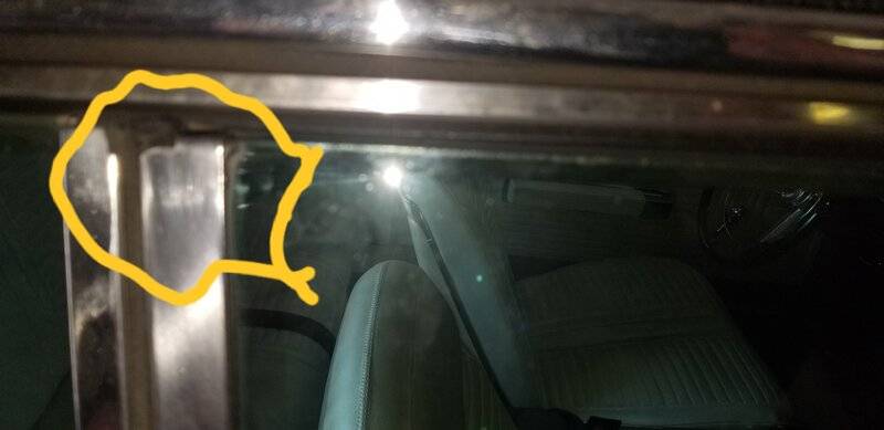

If you let the quarter glass roll up into the grove and let the door glass lay against the seal you will cause a air leak in the area I circled.
Ok, not sure but I’m going to put you down as a second vote for door #1 along with Jerry - which appears to be in the lead.

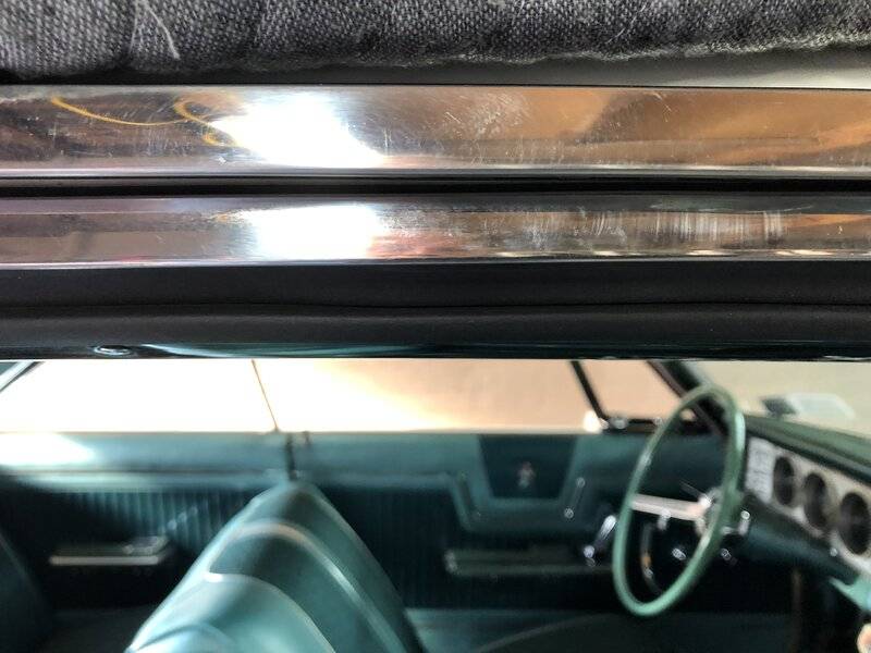

Ok, just trying to figure out what's right for a 64-65 as i'm at this point with my rebuild. Guy down the street has a 65' Coronet ( same basic roof) and the 1/4 glass goes between the two "lips" of the seal and the door glass pushes against it when shut. I can't remember who made my roof rail seal but there is a muted difference at the door glass/ 1/4 glass joint. Perhaps the 66-67 cars are different. I to question the ability of the seal to properly seal in that area with one being in the grove and the other against it, maybe Mopar made an improvement in the later years,idk.
