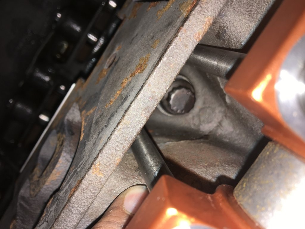

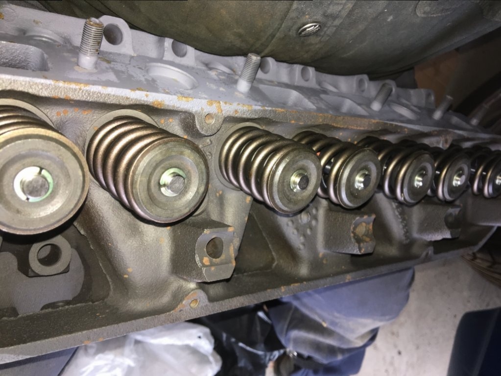

Screwing together 70 v code Plymouth 440.
Had 11/32 valves and good springs retainers etc put in the stock 906 heads
Running comp magnum 270 cam
Have Harland sharp rockers but haven't checked clearance on the stock valve covers. I'm away from the motor at this time so my question is has anyone ran Harland sharps under their stock rockers? If not then what rockers?
Thanks
Dan
I had to grind a round corner on the adjuster side of the rocker at each end exhaust valve rocker arm and remove tin cover on the fill hole.
