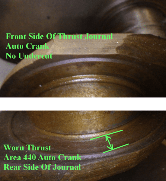

clunking noise could be our thrust bearings
anything move back and forth?

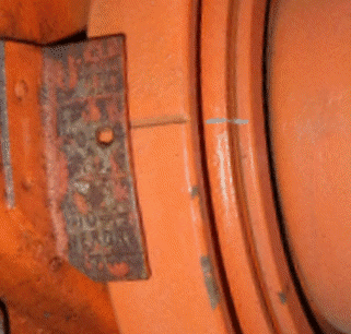

Mark the damper inner and outer so you can visually see any slip...……...
Here's a 440 automatic trans crank with a worn out thrust...…….

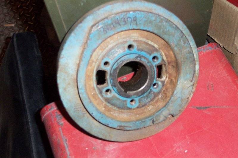

Here is the 400 cast crank balancer.
400 4-spd cars and trucks got a forged crank and a different balancer.
