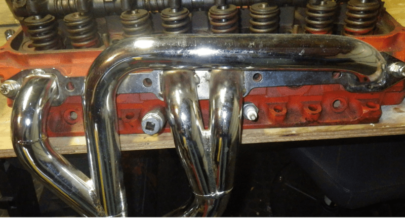

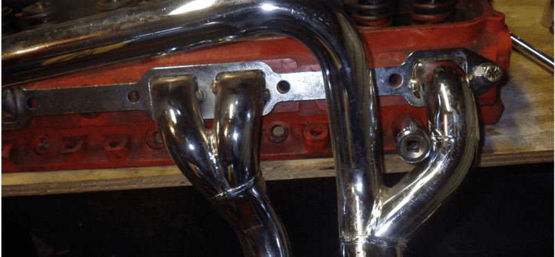

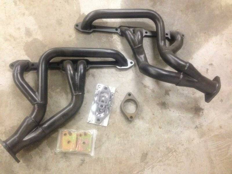

Has anybody seen headers like this?
Richard Cranium
8:00 AM
Feb 20, 2012
58,008
197,571
Maskachusetts
They look more like tubular exhaust manifolds. Just for curiosity, who makes them?
Those look to me like tri-y schumacher's. Rumor i heard, is that Schumacher is out of business, but that his headers were made by TTI. I dont know if that is true.
Looks like Schumacher. I installed a set on my '68 Dart with a 440 and power steering. I really liked them. The 440 came out of my Charger that had 1 7/8" TTI headers. Both were just mild street cars, I couldn't tell any difference in performance between the 2.
https://www.engine-swaps.com/Pages/ProductsType/BRB_Headers.html
Those look to be Schumacher Tri-Y headers that have been modified. It looks like the collector has been extended a few inches.

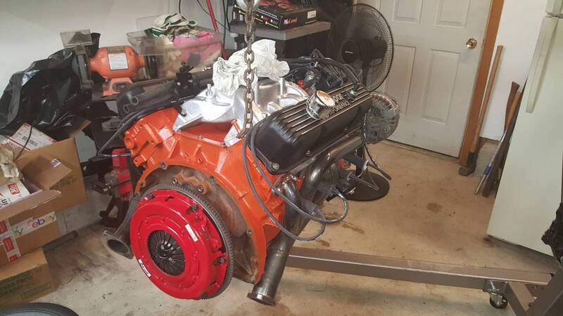

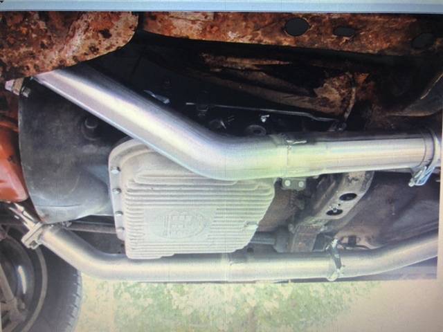

I thought it looked funny, I made my own head pipes and don’t remember them hanging that low
Was that an automatic om manual?
Memory check for ya'......
How was the plug changing chore on 6 & 7?
TriY passenger side.....
#7 plug access kind'a sucks on the driver side. I couldn't get a 6 point on it at all. A 12 point goes though. Then too, the steering I'm thinking is gonna' be an issue. I see on the site there is a mod required to clear the stock clutch setup....
I though the passenger side of a tri-y was supposed to be 2&4 connected, and then 6&8 connected into "Y"s?

It was an automatic, I'll post some pics tomorrow if I can find them.
My 440 had Edelbrock RPM heads and I don't remember any hard to reach plugs, but I do have a bad memory.

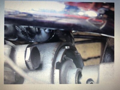

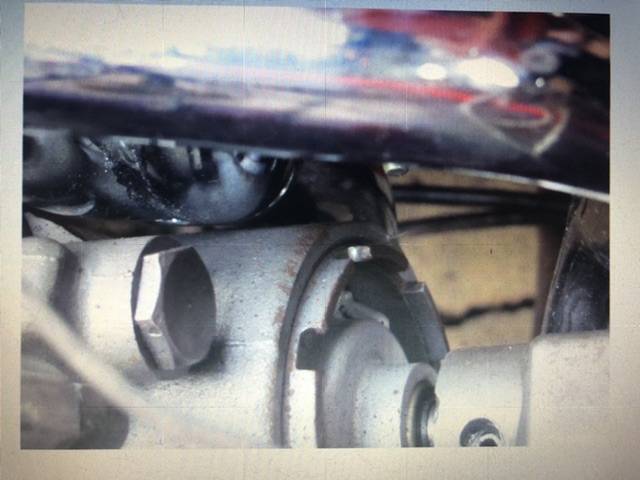

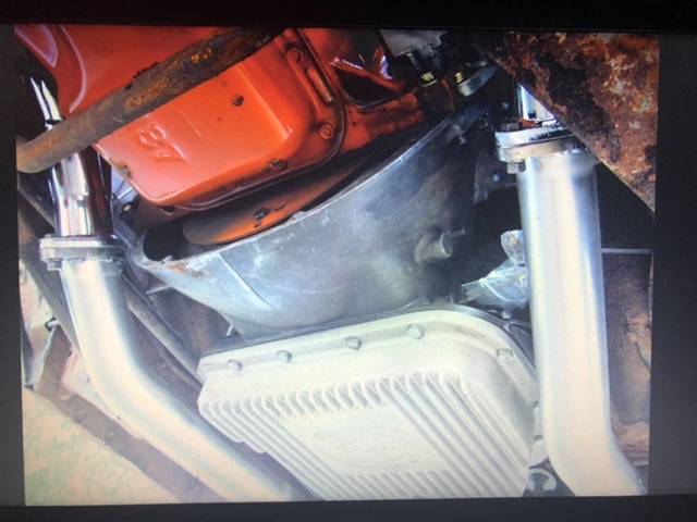

The pipe on the drivers side was closer than 1/4" to the power steering gearbox, so I did use a heat shield there.
Here’s pics of how close the pipes were to the power steering box in my ‘68 Dart. And pics of my head pipes.
