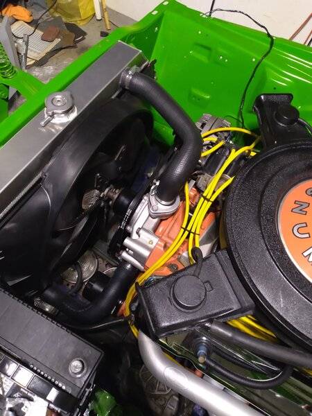

I bought and installed one in a 67 Charger 383 automatic car for a friend. This was a couple of years ago and no issues.
Yep! I went by Jerry Hall had said about therse radiators working well in Alabama weather. I used a stock shroud on mine with no fitment issues also. Thanks Jerry!
I got a 26" from the Same vendor, not sure if it's the exact same one.
I am very happy with it.
Car runs right at 180, and that's with no shroud.

I bought one of those for my 71. The cap ears sit at 1 and 7 o'clock, not parallel. I am using the 71 26" shroud and it fits fine.
See that would be a deal-breaker for me, if they are trying to mimic a stock radiator they have to have the cap in the right position too.

The one I installed needed no adjustments to anything. I also did the painting myself.

Send an offer like I did. Direct fit, 5yr warranty. My buddy in Phoenix has one in his 73 big block air car, and swears by it after 3 years so I bought one around this time last year, works great!
