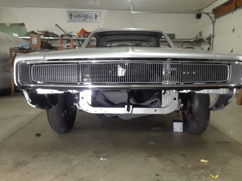

heres one
looks a lot better than my 50 years old one, plastic is softer, as with all aftermarket parts there was some filing and drilling to get it to lay close this is not its final install this was last winter, I'm still waiting on engine to be completed then final install, if I can ever find any time.

Thank s so much ! You put it in the “ old “ headlight support or use a AMD Repro Frame ?
old support blasted, primed, painted. bought the bolt kit but the plastic washers for the top looked very cheesy so I blasted clean the old one's with walnut shells they look way better. save everything when you take that apart, I think I used some of the old bolt also.

Just for interesting Don, the Repro was paintet silver already by the manufacturer , or the grille parts comes just unpainted ?

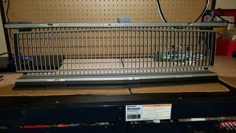

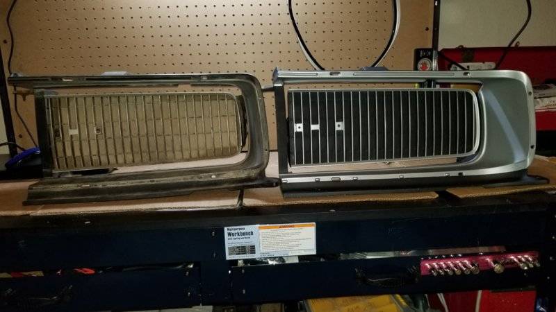

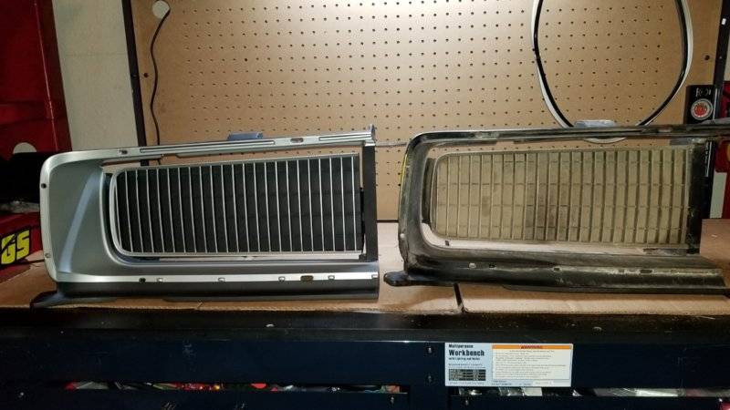

My new Classic Industries grill came in yesterday. I took a ton of photos, I'll post a couple here. They are the center section, left and right extensions with doors temporarily in place.
I have not tried to fit anything yet but I like the overall quality. I see what might be warpage, but when I look at the originals, they have similar defects. The paint lines are clean, and while the new parts may be slightly lighter, they seem sturdy enough. I suspect I'll need some patience and maybe a heat gun when putting this together. I'll take photos of the process and post them as I get time. So far, I would say this grill is more than good enough for even a nicely restored daily driver, we'll see over time.
