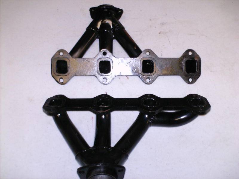

I've done the research on this but not sure if I'm missing something. The TTI ones are too expensive and also they are bigger tube diameter (1 7/8") than I want. I've Seen a few messages on the poly 318 yahoo group but they are minimal, no finished stories or pictures that I could find. Haven't found much on here excpet people saying its too much trouble.
I'm leaning toward this options. I hear the new 1990's 5.7 L gen 3 hemi headers have identical port spacing (the flanges could be cut out and replaced with proper ones) They would fit on the head. But my questions are would they clear the power steering pump? That's seems like my biggest clearance obstacle but I haven't heard much mention of that. It seems people mainly worry about clearing the motor mounts and oil filter. Do people even attempt this in the b body ? Or do the people who try this have early poly pickup trucks with more clearance? Was thinking of trying these. https://www.summitracing.com/parts/psm-70-1374/make/dodge
Or if I become convinced the modification avenue is impossible I may try to make some that will fit from scratch with 1 1/2 or 1 5/8 tube. I don't even care if they are a little funky as long as it's an improvement from stock manifold. Does anyone know more about this picture I found online? Seems like someone made some... question is do they fit? If so I'd probably try to copy them.
I personally don't like that 2-into-1 primary pipe design one bit. Your general idea sounds reasonable & if you're a top-notch welder and maybe have access to a tube bender, then go for it. If not, even with the tubes that are too big & the high price, the pre-fabricated headers will save you tons of frustration & likely a little money too. Just my 2-cents. Didn't '66 Coronets have poly 318 engines available? If correct, that would be the car I'd do my header search with (you probably already know this).

Just curious, why do you dislike the 2 into 1 design? Obviously it's not as good as individual tubes but I would think it would be a significant improvement over the small manifolds? or not?
I may try to to modify the header's I linked to. I'm thinking best case I will only have to cut it off at the flange and weld it to the proper one at a different angle maybe. Worst case I have to also cut out sections of 2 of the tubes to re-route them.

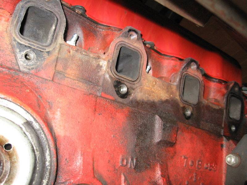

Now I'm starting to think it may not even be worth it. I'm not sure how much flow the stock head will even allow (does anyone have any opinions on this?) And there's no way I could afford head porting and machine work at the moment. The PO did say the the heads had been machined but I think they may have just cleaned up the valve seats, and did not do much porting if any. The PO also said the cam was reground by the same shop. The car has a 625cfm AFB.
Are the stock 318 heads restricting this motor more that the stock manifolds are?

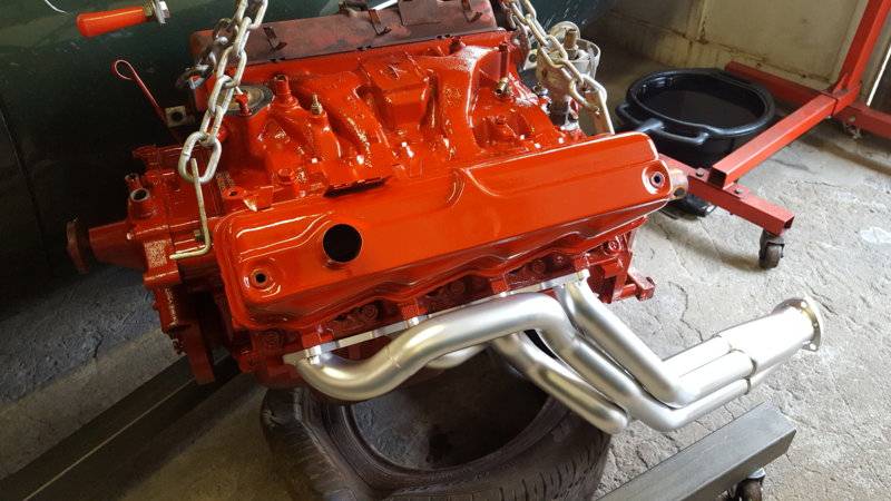

( Photos just for reference.) No the head flows fine for 318 Cubic Inches. Those ports look similar to the Hemi.I would say that you will be very happy with the results with the plans you have stated. Just Intake, Carb, and Exhaust Made a BIG difference when I had mine.That was with a stock cam and valve springs. I added 3.55 gears over the factory 2.76.The car would light the tires.
That was WITH the stock manifolds to 2 1/2'' exhaust before the TTI's

Don't need a oil filter adapter with the TTI's Filter fits fine. View attachment 679336 ( Photos just for reference.) No the head flows fine for 318 Cubic Inches. Those ports look similar to the Hemi.I would say that you will be very happy with the results with the plans you have stated. Just Intake, Carb, and Exhaust Made a BIG difference when I had mine.That was with a stock cam and valve springs. I added 3.55 gears over the factory 2.76.The car would light the tires.

In the photo is the engine with the Chrysler Power wind tunnel intake($650) and a stroked 390 Poly that a friend has with a 750 Edelbrock, all the new Poly goodies and TTI's and full exhaust. This thing flat out flys and will give a Big Block a run for the money.
