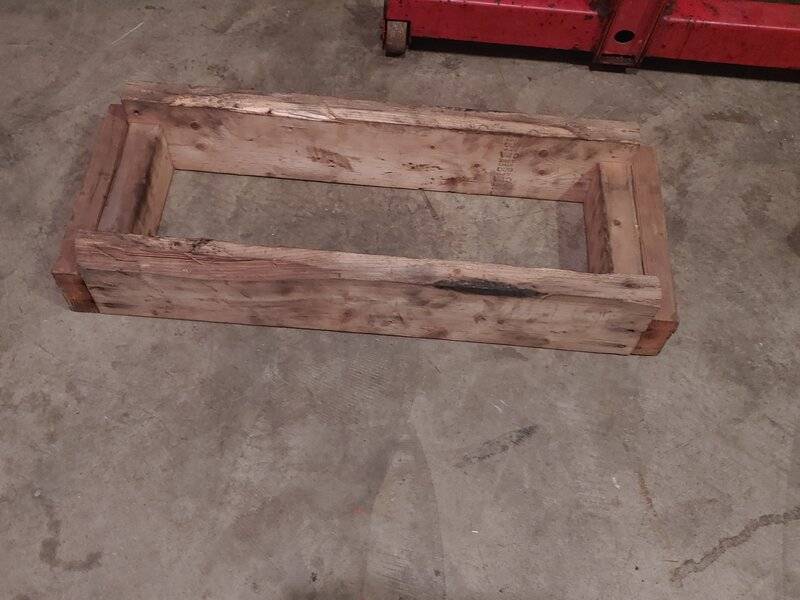

yeah you can measure the flat surfaces/spot where the oil pan mounts
make a loose-fitting box, like an extra 1/4" wider & longer opening
or so, out of like a 2x8's, I do so, so the sump has plenty of clearance
or even some thicker plywood would work too, cheap & easy
screw it together
(old carpenter, always have wood around)
IIRC 2x6's would work for most sumps too,
leave the front & back pieces extra long,
3"+ on either side, like an extra 6"+ longer,
so it won't tip, has more stability
put casters (locking even better) on it & easily moveable too
or build something out of steel

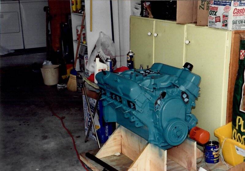

On Chrysler Big Blocks we use a cou[le pieces of 2x6 lumber. One down each side and one front and back. The engine then sits on the back just behind the oilpan and the front again in front of the pan. Front is notched for oil pump. Probably do something similar for your needs. Ruffcut

I've shipped engines all over the world and at least a hundred or so in my time when I worked for Chrysler and that's how I did it.
2x6 frame as suggested. Shrink wrap it with thick packing wrap, you don't want to fight a flapping tarp cross country
