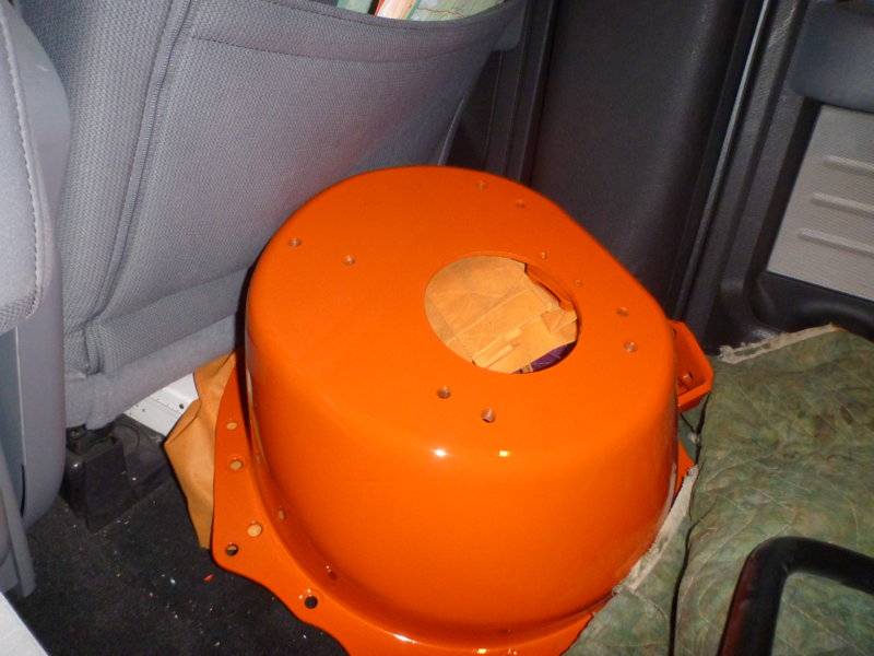

This is a pretty old bell, I bought it used in the mid '80's probably. I was under the impression the pivot bracket was welded to the bell, but it may be bolted to a welded plate. Would have to pull fork to be sure, and do not want to do that right now. I do run a block plate, but drove it for 2yrs before changing flywheel, with no issues. The ONLY change was new flywheel, indexed the bell housing, and rebuilt the trans.

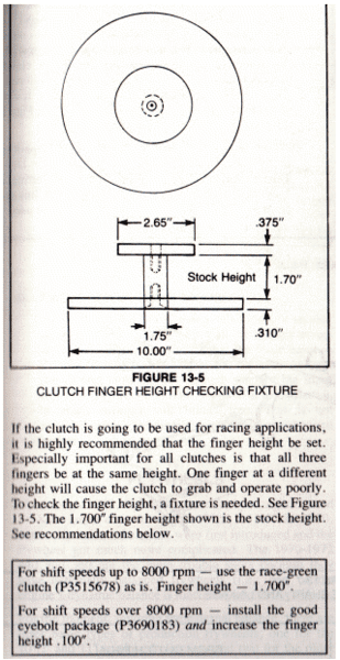

FWIW, a .310" standard under a B&B should have the finger heights at 1.700". So 2.010" from the flywheel face.

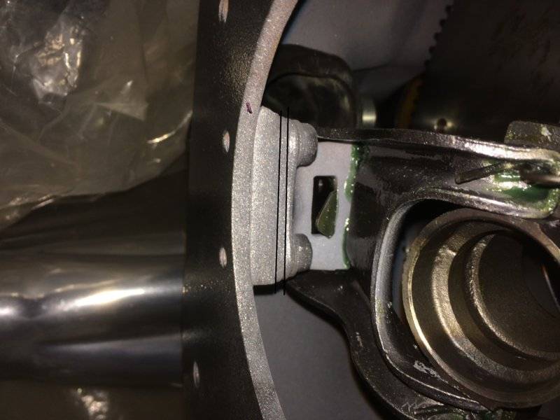

You saw my picture correct? There is a spacer under the pivot bracket to match the block protector plate.
here's a shot of mine. The spacer is between the two black lines. Also stock '69 b-body fork.
