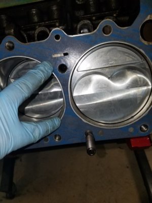

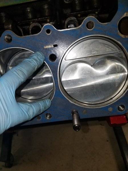

So I was mocking up my motor this weekend and noticed that some of the coolant passages were partially/totally blocked. Is the slit normal, and the lower passages are totally blocked???

Yes sir, they seemed pretty loose around the studs I placed ( only 3) for mock up. Noticed that they dropped down and could slide out of alignment.
Thought about some copper cote on the corners to help hold them in place. Of course when I did this I did not have my deck facing straight up...
I was told the gasket slots were to slow down coolant flow....gives the coolant more time to pick up heat.....sounded good to me, but I m no engineer , went to public school.....

Fel-Pro 1009's have a bore diameter of 4.410", a 0.060" overbore is 4.380" so you shouldn't have an issue like that.

The head dowels are supposed to keep the gasket in place and not allow it to move. If you are missing the dowels, or they are damaged and do not fit snugly in the gasket dowel hole, replace them. Please resist the urge to use any copper coat on the head gasket.

Ya I ordered some new ones last night after thinking about it, mine were removed for machining and not replaced.:thumbsup:

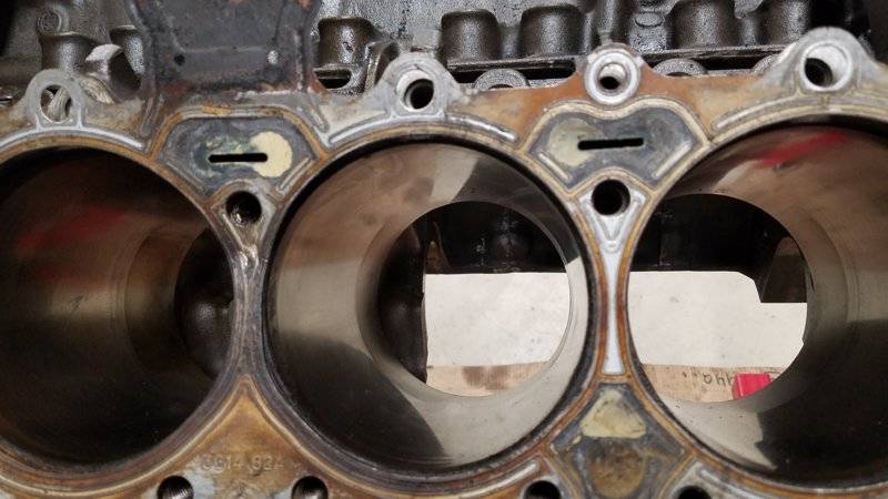

Here's a pic of an OE gasket for posterity...first head removal since factory assembly, '78 440. Same skinny slots even with the bigger figure-8 cooling holes.
Looks like the slits are more centered over the passage on the stock gasket than mine and I cant tell in the pic are the lower passages blocked off ( closest to header side)? Mine are...

Earlier blocks just had a round hole, but later 70's blocks had a larger peanut shaped hole

As 69Bee said, the later blocks have a bigger hole. (If you look real close at that gasket you can see the crud outline of the figure-8). The only holes at the exhaust-side of the gasket are for the head bolts, just like your fel-pro. For water, there are the slits between the cylinders, a big hole at each end and that's it.
