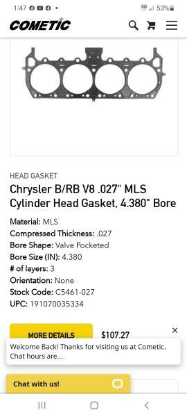

To increase my compression a bit, and get a better handle on the internals of my engine, I am looking to replace my head gaskets. I have a 440 based 512 using a 440 source kit. I have searched but cannot find the proper bore size I should be looking for. I plan to go with a Cometic gasket. They have a .027 thick gasket in a 4.250, 4.350, 4.410, and 4.500. Which would be the proper bore for my application? Any help would be appreciated.

What is your bore size.
4.375?
4.380?
I think they make gaskets for up to bore 4.380.

At this point, I would need to take the heads off to measure the bore. I was hoping the 512 kit had a standard bore size to work with. What I am trying to avoid is taking the engine apart to measure and then waiting for weeks to get the proper size gasket and get the car running again.

That kit comes in several bore sizes. The largest they list is 4.375". There is only one way to tell what your bore size is, and that is to measure it.

Based on the info that I was provided about the engine, and a chart I found on the 440 source website, the bore is either a 4.350 or a 4.357. Cometic site lists gaskets with a 4.350 bore or a 4.410 bore. Is narrowing down my bore size to the range I found enough to select the correct gasket, or am I still tearing down to measure?
