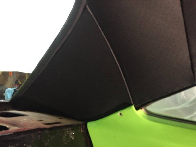

See mine after replacing, this is for a '69 B body but guess it same or similar on a '66.
69 charger goes behind the headliner.....69 Plymouth overlaps the headliner.......
