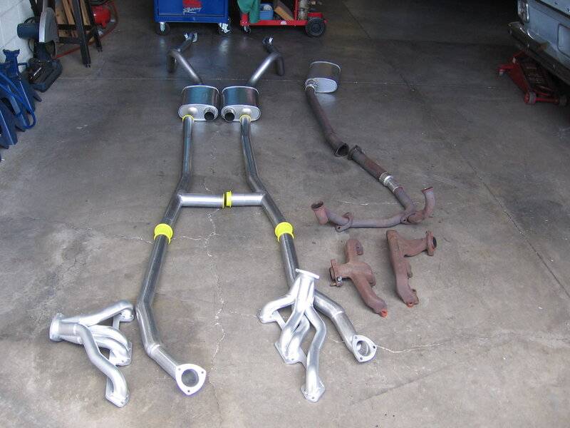

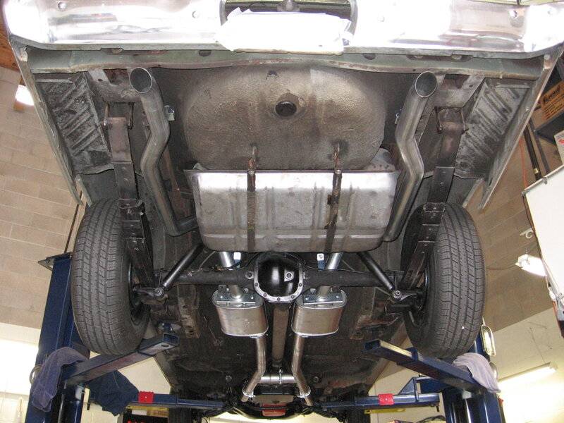

Aluminized steel DynoMax mufflers.Did a 79 300 not long ago. Also a 68 Valiant with shorty headers.Just some eye candy.
I've been installing TTI product for years now. Looking at their site B Body with mufflers price is $714 and whatever shipping is.
Aluminized steel DynoMax mufflers.Did a 79 300 not long ago. Also a 68 Valiant with shorty headers.Just some eye candy.View attachment 952251 View attachment 952252 View attachment 952253
Nice pics- thanks ! Yes, i think. $714 is much more realistic than $1240. Accurate is including a set of stainless tips, in that price, but still $1240 + ? Does tti tail pipe reduce to 2 1/4 ? Or is it 2 1/2" all the way. It seems most suppliers only have the original style muffler hanger/ clamp in 2 1/4 and not original style in 2 1/2.
2 1/2'' to the bumper..Unless you want 3''. They have that too.

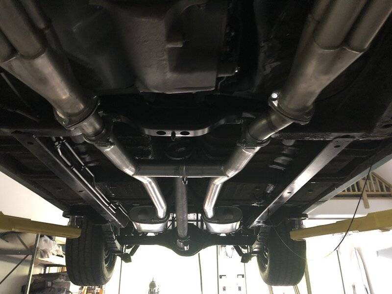

I just finished installing a TTi 2 1/2" H-pipe exhaust in my Coronet. Good stuff you really can't go wrong with it. Comes with Dynomax Ultraflow mufflers. I didn't spring for the tips. Was around $700-something.
