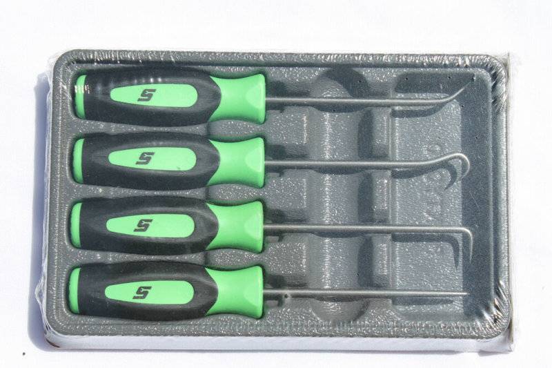

If it is a lot of rtv you can take a small 90* pick and shop vac and work over the holes.

Invest in a set of these.
https://store.snapon.com/Miniature-...nct-Soft-Grip-Miniature-Pick-Set-P891665.aspx
Every time I go to the dentist I ask them if they have any tools they are throwing out, always come home with at least 4 or 5 ! May as well get something as a bonus for his $250/hr !

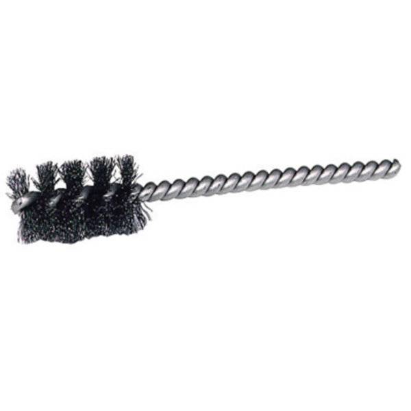

Get a 3/8" diameter round wire brush, cut the handle end off of it, chuck it in your drill and run it in reverse. They make them for drills also...
