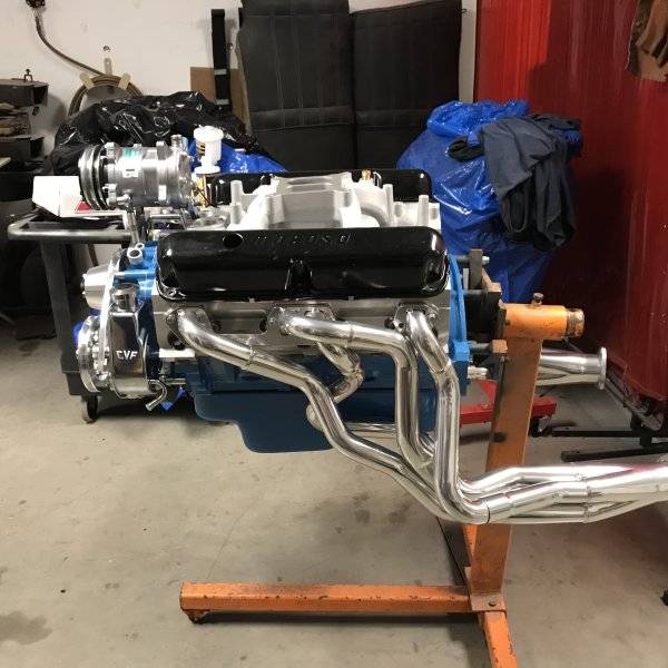

I put these on my A100 with a 360 block recently.
No noticeable loss of giddy-up (seat of the pants experience only) - had mine heat-coated also.
https://www.speedwaymotors.com/Patr...t-Tuck-Header-Mopar-Street-Rod-CC,301696.html
Ignore the date on the oil filter.....that was changed a few weeks ago. :lol:
