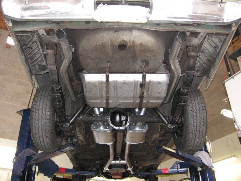

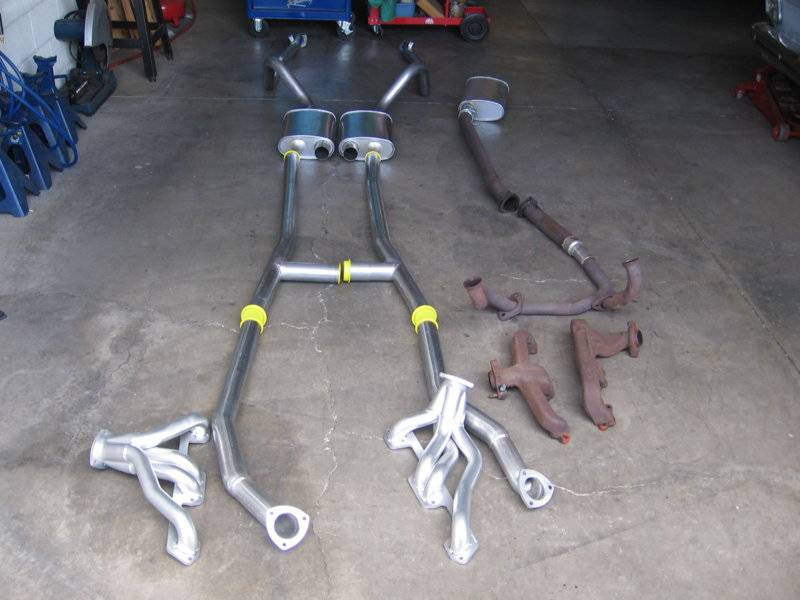

If you think about it, it's one call and done.Yes it's costly.I've installed many,at least 20 sets of complete exhaust systems from TTI. This was the last and were their shorty small block kit for a A body.(See photos)
