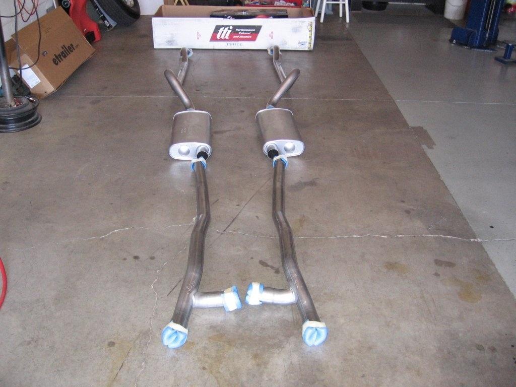

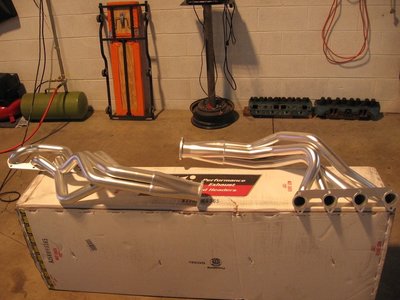

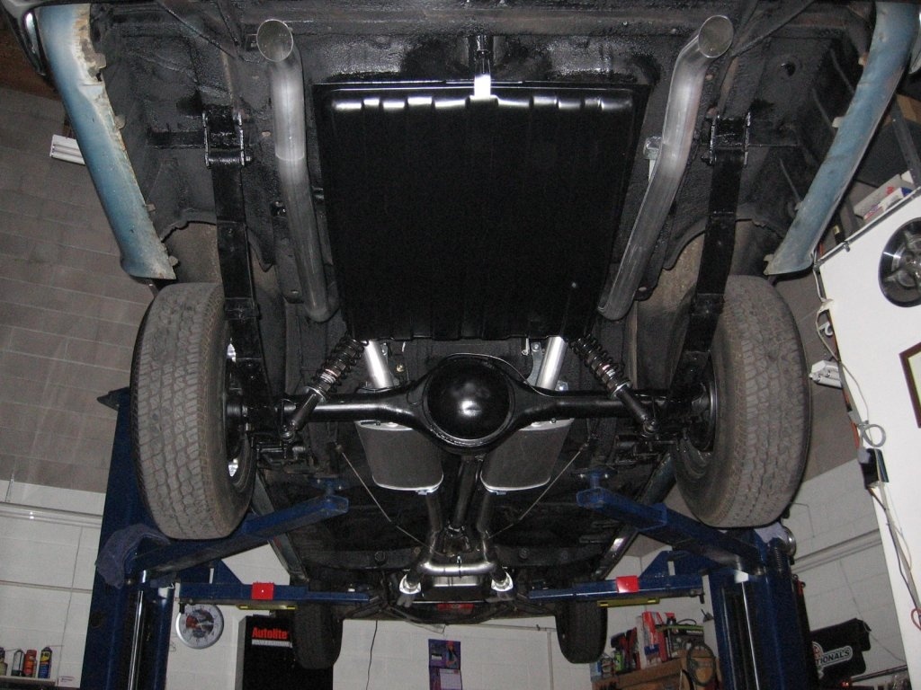

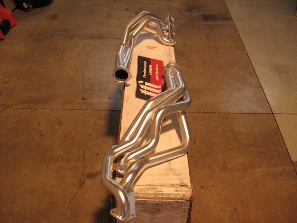

Sure,, but expensive.Tube Technologies Incorporated . It is well worth the money. I had a local exhaust shop do duals off the cast manifolds for about $600.Then I installed TTI poly headers and their complete exhaust.Cost was about $1200 10 years ago.This was on my 64 Belvedere.
TTIs are the best quality you can buy, probably don't need headers on a bone stock 318 unless you're planning on mods in the future. You could get dual exhaust on a 318 in 62. I had that dual exhaust setup with glasspacks years ago on my 63 Fury. It has to help some with better breathing, but it sure sounded a LOT healthier. A small four barrel carb and manifold might be money better spent than headers right now.

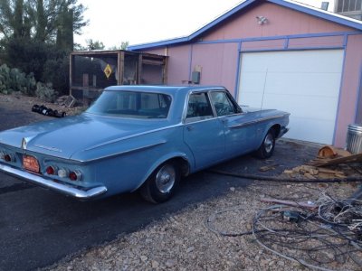

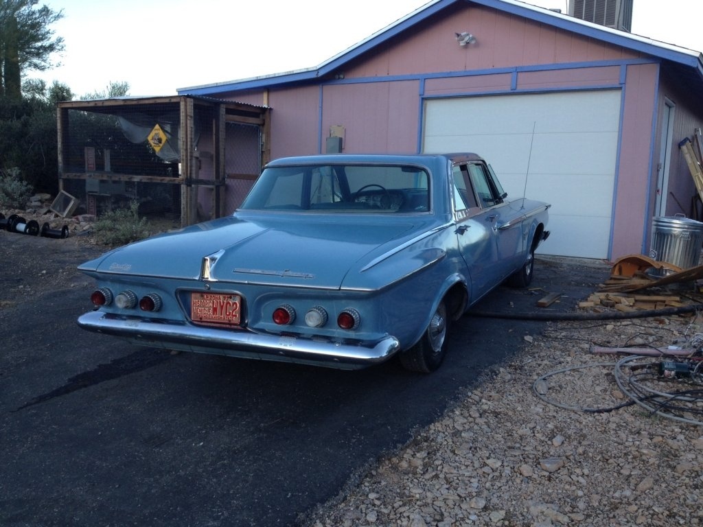

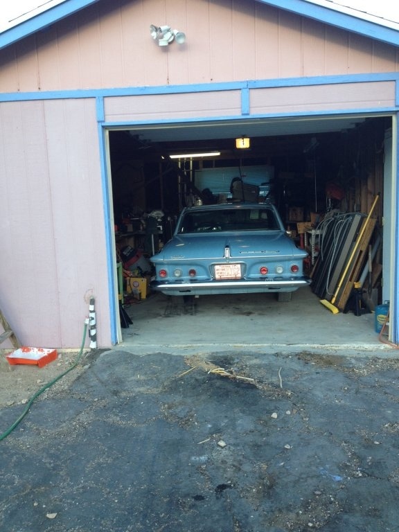

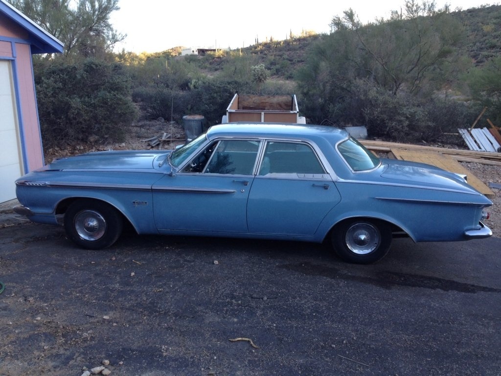

Many thanks for all the replies and photos.

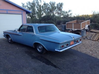

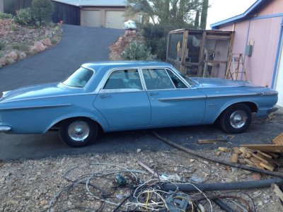

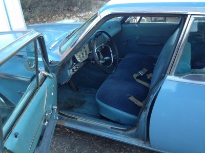

Here are photos from October when I got the car. Tucson original bought new from a mechanic that worked at Beaudry's dealership from 1940-1973.
He retired and gave the car to his daughter.
Original TF tranny and factory air.
Was painted in1987 along with interior seat covers.
Needs resto, but is fine daily driver.
1962 Fury October 2014 (3).JPG 1962 Fury October 2014 (4).JPG Fury 1962 5 Oct 2014 (2).JPG Fury 1962 5 Oct 2014 (4).JPG Fury resto Oct 2014 (1).JPG Fury resto Oct 2014 (2).JPG Fury resto Oct 2014 (3).JPG Fury resto Oct 2014 (4).JPG Plymouth Fury 1962  Oct 2014 (3).JPG

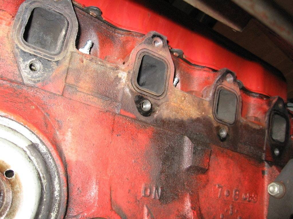

Are these 318 headers? Distance from #1 bolt center to #7 bolt center is 15".
fwi, sure looks like they may be. flange looks the same
