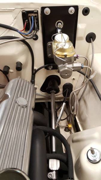

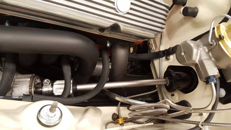

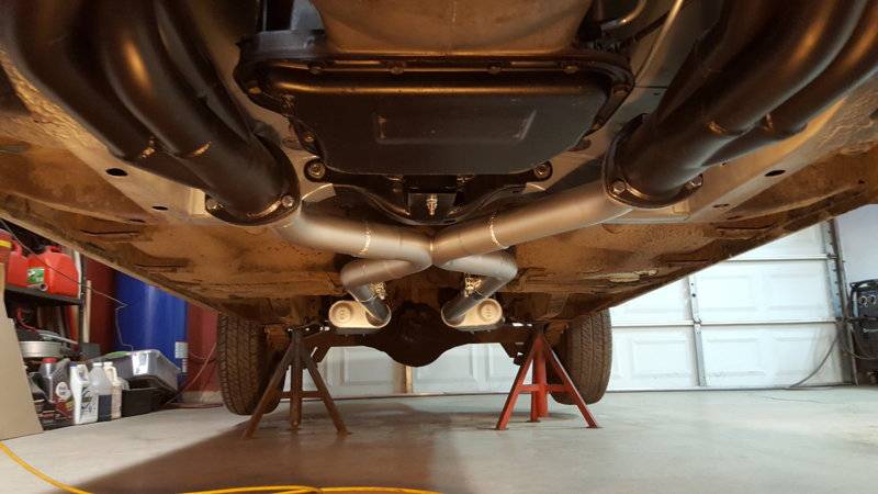

View attachment 608874 View attachment 608876 View attachment 608877

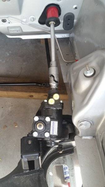

Thats exactly how i want my exhaust to look. I see your stear
ing rod is pretty close to that back pipe. I think im going to have clearance issues with that. I had to cut my rod and put in a stearing coupler that is probably right where your rod is closest to that back pipe
With the Borgeson box and coupler, I wouldn't know what clearance you have compared to the stock one. I see the shaft seal isn't centered in the column tube. You can loosen the three bolts on the firewall and let the plate come over.
