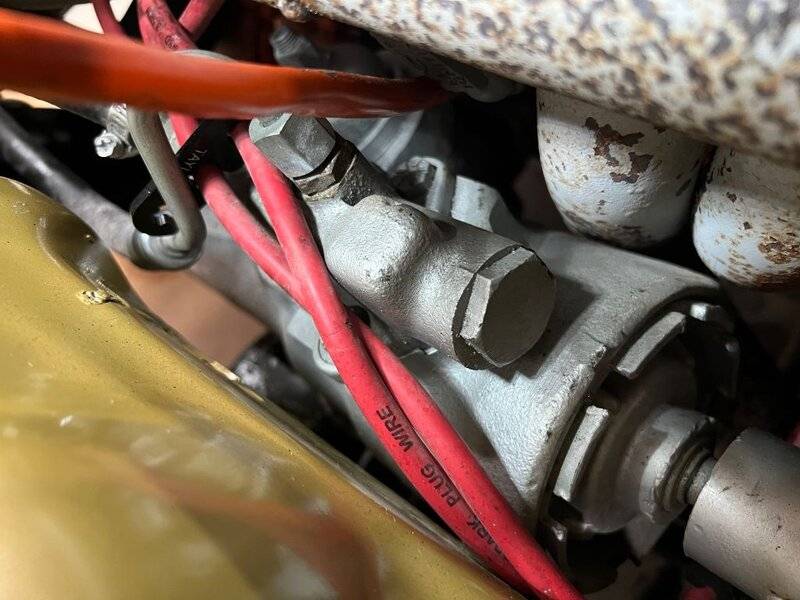

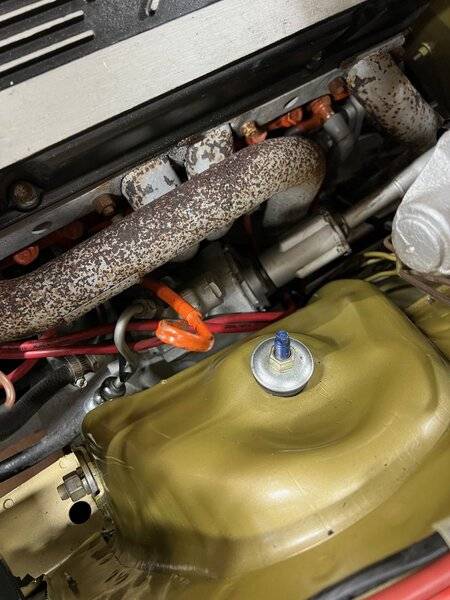

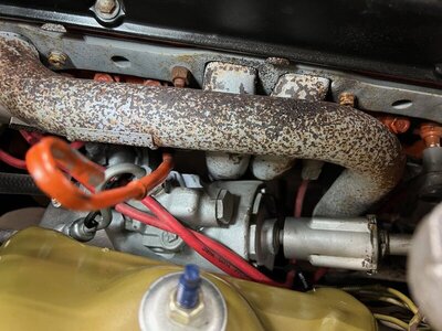

My 69 GTX has an old set of Hedman headers that are clearly hitting the steering box off my #3 collector. It appears to be an OEM steering box. This is my only interference I've found so far. I was contemplating temporarily solving this by jacking up the motor a bit and sticking a bar in there and dropping it down a few times to bend the collector. Sound approach? Anyone recognize these Hedmans?

looks like they've been like that for a while! maybe just get some insul. on them!
being old they might not take to the reshaping well!
They are definitely touching. I have a vibration on the highway on throttle that logic says this is contributing to. Not sure I can slide anything in there but to your point I could "dampen" the contact by jacking it up and sliding something in there
A thing to consider is the motor mounts are old and sagging allowing the motor to move from its original location with the headers just off the steering box to laying right on the steering box.

Good point Cliff I'll check that. The car was on rotisserie in the last 2 years I would think the mounts are new. But given they put on junk headers its possible!
They look like they clear now. To me on acceleration fore ward it should lift up and not hit. Reverse under load it might hit. If an automatic have someone brake torque it in for ward and reverse while watching.
Maybe you can get more clearance by loosening drivers and passengers motor mounts. Raise engine and wedge motor to passengers side and lower motor while wedged.
Can u just put a dent in the tube? Engine masters did a dyno test on dents vs no dents. No measurable change.
Install new mounts add 1/4 plate under the rubber part of the mount and should take care of the problem.
Trust me, I feel your pain. Hedmans fit lousy on our big blocks.
Mine have been "massaged" heavily in a couple places to give me more clearance -
off the car is a ton easier to do that.
Even after doing that, they make changing plugs a chore when it doesn't have to be,
but as long as they don't leak and remain solid, I reckon I'll keep 'em, "Ed customized". :)
Time for some TTI's. I went from Hedmans to TTi and fit perfectly.
I had to dent my TTIs to clear my power steering box despite good motor mounts and the car never being in a wreck.
Need to take them off to be able to hit hard enough to dent them. Trying to dent them by prying against steering box might be a bad idea.
Also mentioned before is worn motor mounts, saw on Nick's Garage a motor that sat lopsided due to different height new motor mounts.
