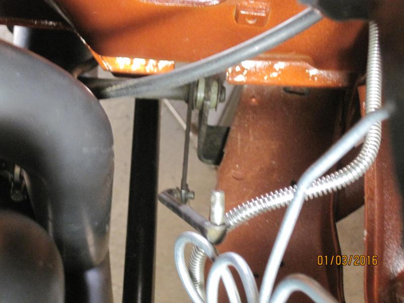

Got the engine/trans installed a couple of weeks ago. Went with Dougs D452 headers. There is plenty of room for the tranny linkage, the headers are closer to the starter and the T-bars than they are to the linkage.
Looking down the driver's side. With the steering column out the shift rod is resting against the m/c brake lines. It's possible once the column is in the shift rod will be close to the #7 header. I'll update when the column is in.
