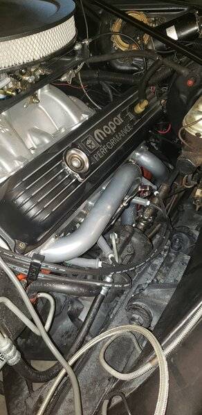

If they fit a 75 they will fit a 77. Save your money for a good quality headers. You only want to r&r one time. They aren't easy to get in. The drivers side motor mount needs to be loosened and the engine raised a bit to get them in. If you have a factory starter you could have fitment issues too. I bought a mini starter with built in heat shield when I installed mine making it easier. Passenger side header goes in easier. First set of headers I bought for my 77 Cordoba are ceramic coated Hedman headers many years ago. They wouldn't stop rusting even after getting them recoated a couple times. I ended up with TTi's last year. Nice fit and so far so good.

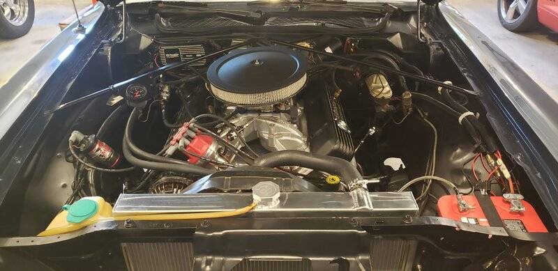

View attachment 972000 View attachment 972001
Great info and great car you have there. thank you!
