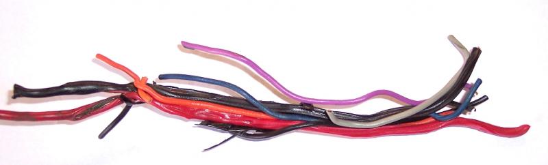

If its not the switch. Id check around where ammeter wires run through the fire wall and up under the dash. Had my headlights go out found the 40+ year old wiring had melted and fused its self together.
Hope its not that cause your high beams still work, but if you havent id recommend changing them out as preventative.
