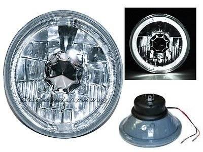

The LED bulbs cost over $100 each and require a new headlamp housing like the ones Octane Lighting or other companies sell. However, theses usually require cutting either the headlight bucket or the radiator support or both due to the larger backend. Here's a picture for illustration purposes.

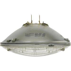

Geez... I'm missing something. I've been using this style of Halogen bulbs for $16 at Autozone for 20+ years and never modified a thing. I started using this type instead of the factory sealed beams around 1985 or so. Are the conversion/small bulb type any brighter?

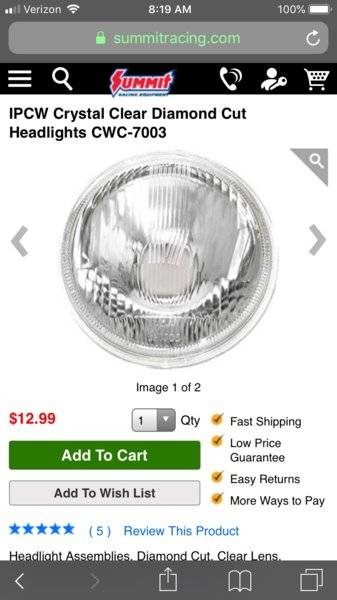

I use these headlight housings from Summit. And use Superbright LEDs. A lot less load on the system. I still used H5001s for the high beams.
