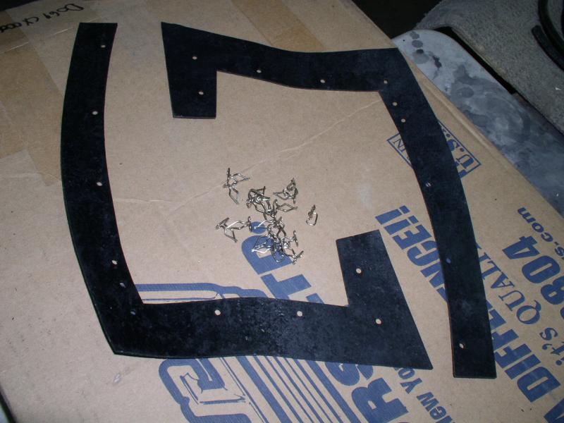

Does anybody out there with a 69 Charger know exactly where these shields go? I bought these along with all the other gaskets and weather stripping for the car, but can't seem to figure out what they attach to.
Description/contents
Complete set of correct fitting 1968-69 Dodge Charger headlight splash shields. These are located behind the headlights under the fenders.
Yeah, I have seen that description as well as the colored drawing in the Year One book. Old age must really be setting in on me, but I just don't see where all the little clips attach to.

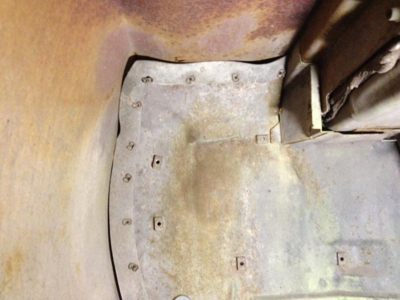

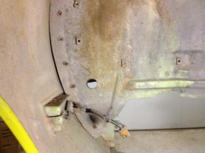

Here it is on a 1970 Road Runner. Hope this helps
Thanks a bunch hsorman. I just needed a good swift kick to get me going in the right direction. All kinds of little holes on the inside of the wheelwell for mounting them. And here I was looking for a spot to tuck them behind the headlights, they are called headlight splashshields after all. Learn something new everyday.
