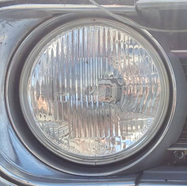

Bosch motorcycle headlights, H4 bulbs, no mods needed.

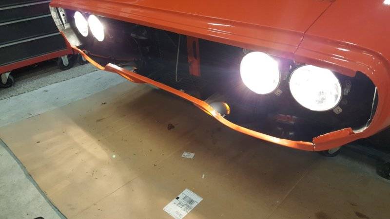

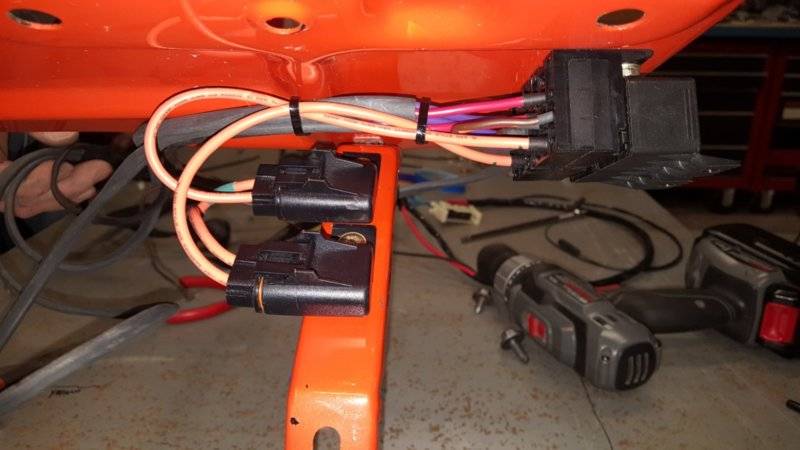

Second member Crackback's. This is headlights on battery power only. The other picture is I mounted his relays under my battery tray, out of the way but can get to it if need be
