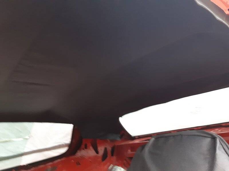

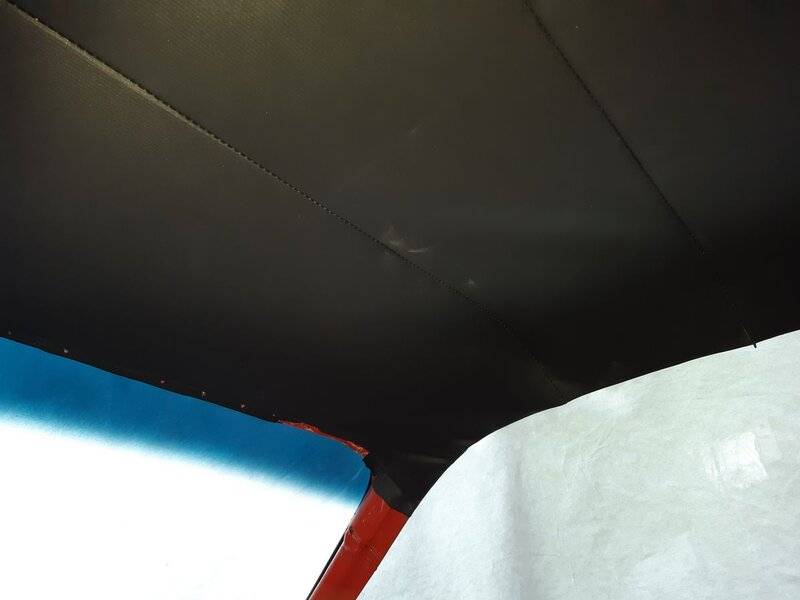

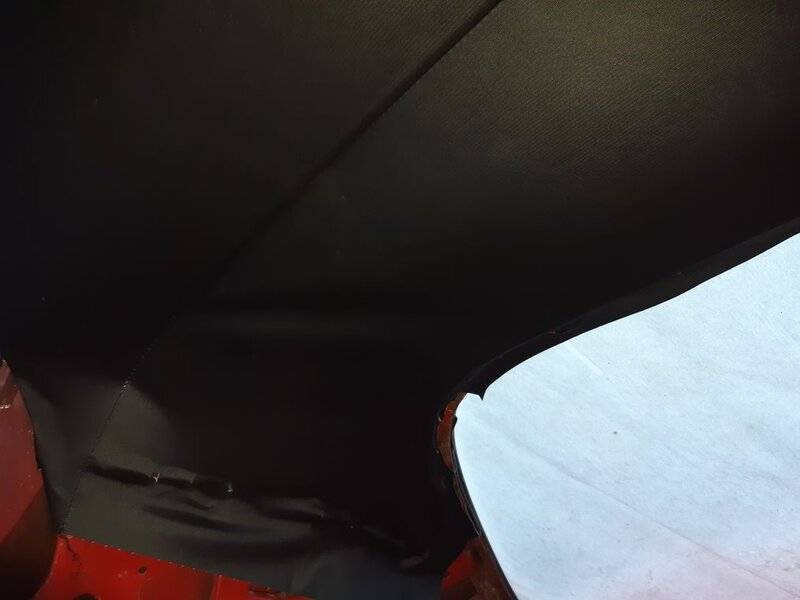

Ordered a new headliner and bows from Classic Industries and finally installed it yesterday. Car is a 73 Roadrunner and headliner is a black non perforated Part#MB303501 and bows part# MP19003. Had a good friend help me, well he did most of the work. He's an excellent body man and has installed many headliners throughout his career. The headliner material was so thick that it had no give to it, took us all day just to install it. Also had to modify the bows stays with a small bead of weld so it wouldn't go completely in the holes. He has never seen a headliner of that quality (or lack of) and compared it to almost the thickness of a convertible material. So I am just wondering if anyone else has come across this issue. And before anyone chimes in on "you get what you pay for" it was part of a larger order. :BangHead:

There's still a couple of wrinkles, hopefully will straighten out in time. Even using the heat gun didn't make a difference. Will get a pic up soon before moving it to a friends garage for the winter.

Took us 5 hours to install. As mentioned at first that it is a non-perforated headliner. Even with both of us pulling on one side, still couldn't get some wrinkles out. Material just wouldn't give.
