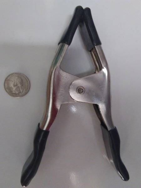

On a side note- you'll need a boatload of good clamps, to temp hold it in place with some tension. Don't waste your money on cheap weak clamps. They pop off.I found these at homer depot for a buck each !
