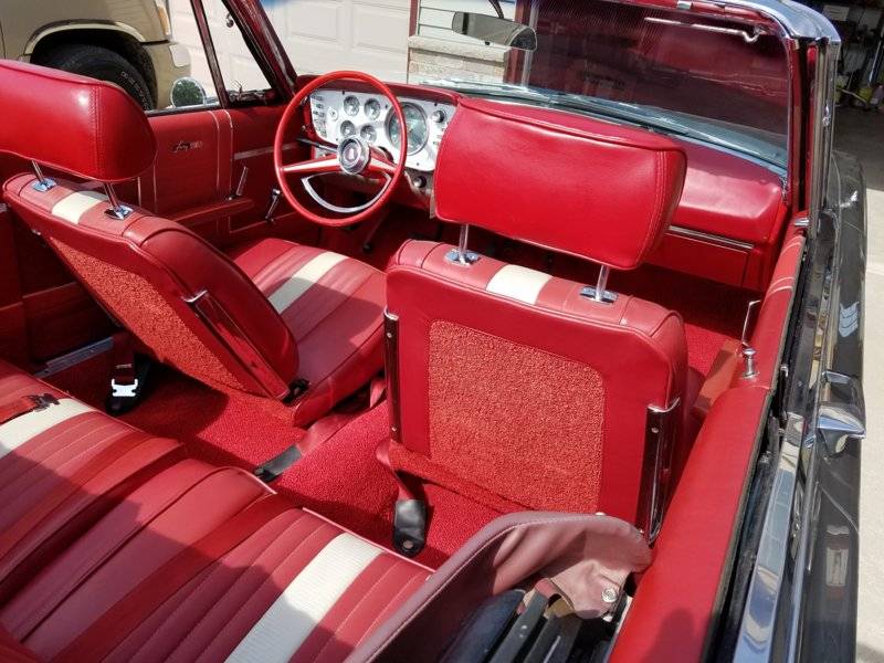

I had installed later 60's rests on my '63 buckets and they don't go all the way down by the lack of room on my early style seats b4 rest were out. I think some models may not fully drop to the rest to the seat as I recall. Harder then hell to move them, at least mine. Try squeezing the posts inward with a lot of effort and should move. Otherwise might try a ratchet nylon strap around the posts tighten until you see the posts inward stress and should be enough to lift them out.

Sure seem to recollect a certain type of head rest...sort of slight oval shaped, that didn't drop all the way to the top of the seat back. Might be wrong. Anyway, the ones I put in can't drop all the way unless I'd cut the posts down; but they're set for my head as set. I had a partial neck fusion years back and my doc said whiplash could be very bad news for me prompting me to add them in my '63. The way I can move them is to squeeze the posts inward with a heck of a lot of elbow grease...

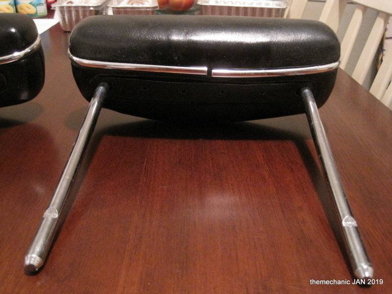

I don't think they were meant to go all the way down on a 69 bucket seat. Here's a photo of my old headrest and a photo of the locking clip down inside the seat someone posted on the internet.

My headrest is exactly the same as the black one pictured above. Today, I considered a ratchet strap. But, that’s not going to work as the width between the post are simply not wide enough for a ratchet strap to work. Im considering removing the bezels. But, I’m afraid the piece pictured above might fall down inside the interior of the seat. Need to come up with a tool that allows me to squeeze the posts inward. Thought of using wire twisted by pliers. The big challenge is the headrest is only a few inches above top of seat. Not much room to squeeze the post together under that circumstance.
