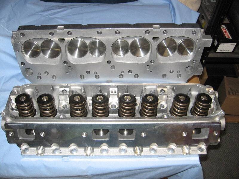

Who has the best out of the box heads for a 383 with stock flat top pistons?
Closed combustion chamber or open? What CC size?
Angled or straight plugs?
Will want to use the stock rockers.
Thanks

I went with Marsh Performance Sidewinder closed chamber heads. He matched the springs, keepers and retainers to my cam profile (all Comp Cam parts), hand assembled and checked before shipping. Good price too.

are Edelbrock RPM's or E-street are the cheaper versions
same exact port configuration,
flow like 290cfm intake, out of the box unported
(Stealths only like 245cfm on a good set)
(Both Edel. heads have an angle plug, 3/4" long reach 14mm plug
no issues really even with plugs or wires, even with stock
restrictive, cast iron manifolds
CC depends on what kind of final compression ratio you want
or how far down in the cylinder the pistons are
what pistons & head gaskets or thickness of gaskets you choose
to determine compression
You can get them (either) in 75cc 84cc & 88cc combustion chambers
Edelbrocks, they flow better than
Out of the box Stealths too (Cast in China)
(unless you go with the MW ports, But; you can get MW ports
with Edelbrock too, Victors lots more special parts involved, more $$ too
they are Made In America Great Again products
good forged parts, good valve, good springs specific for your style cam
you need to specify what type when ordering
& They are all Assembled & cast in the Great ol' USA
in SoCal Foundry/Plants
Sort of generic answer
for a generic type question
there are better heads for all out racing
there are better heads Like 'Air Fuel Research' Heads
the 240 for smaller cids or 270 AFRs for big cid combos
thier also like almost twice the money
if you're not going after every available HP
the Edelbrocks are extremely good heads,
make easily up-to about 700hp
with lil' to no porting at all
IMO Best bang for the BUCK

I like the Edelbrocks/E-Streets .... and we like the STEALTH Heads from 440 Source as well ?
However....
I think it's important to understand
Last time I checked ? the Edelbrocks and E-Streets DON'T FLOW ANYWHERE EVEN CLOSE TO 290 CFM "OUT OF THE BOX" ?
IMO....
and according to our Flow testing on our SuperFlow SF750 Bench the last time I personally went out and compared the two.... The E-Street and Edelbrock RPM are "maybe' 5-10 cfm better than STEALTH.... that's it.... that's ALL !
Last time I personally Flowed the two....
I saw OOTB Flow numbers from E-Street and Edelbrocks in the ~265-270'ish cfm range @ .600"
and
OOTB I saw STEALTH's in the 260-265'ish cfm range @ .600" ?
I still have sets of BOTH Edelbrock RPM's and STEALTH's currently "in stock" here....
Sooooo....
Next week I will personally go out and FLOW BOTH complete with Pics/Video on our SuperFlow SF750 Bench to verify what I'm saying.
I'm NOT knocking the Edelbrock/E-Streets.... but my understanding is the majority of Edelbrock Castings come from CHINA as well ?
