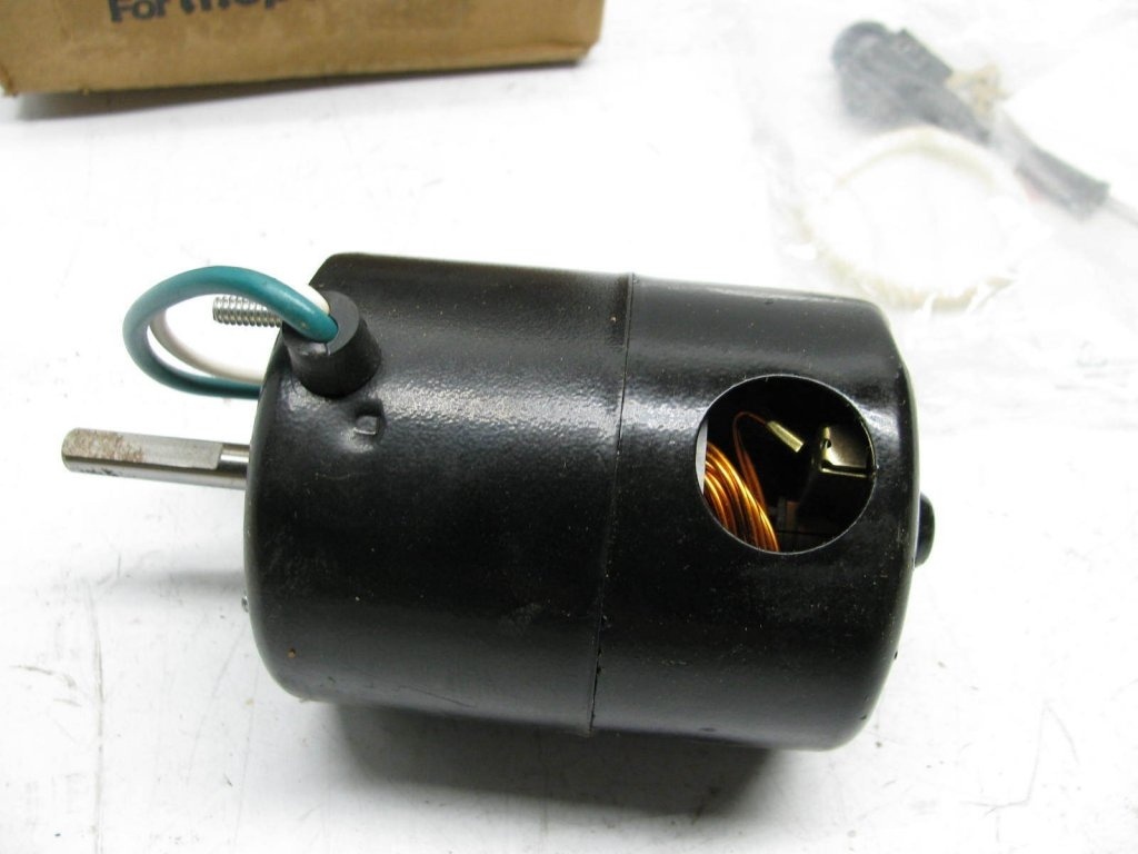

looks to be new,not sure what year car,the part number is 04443101.100.00 plus shipping.

Here's a dumb question, how do these come out? I took the 3 nuts off and the birdcage seems to be larger than the hole its in and won't come out. Is it just corroded onto the shaft?
No dumb question in my opinion. If you don't know, you don't know and that's why there's forums like this.
Anyway, I'm sure it should pull right out, after you take the fan or "cage" off. That is how mine came off
Ok thanks, but how does the birdcage come off? Do i need to get after it from the inside? I unbolted the motor...
There should be a "C" clip of some sort holding the bird cage on the shaft. Look in the middle of it and use some needle nose pliers to get the clip off of the shaft and it will slide off.
