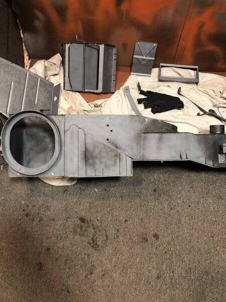

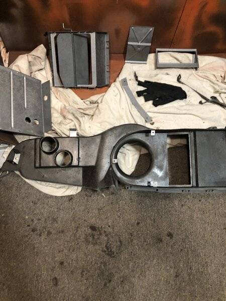

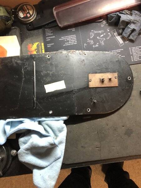

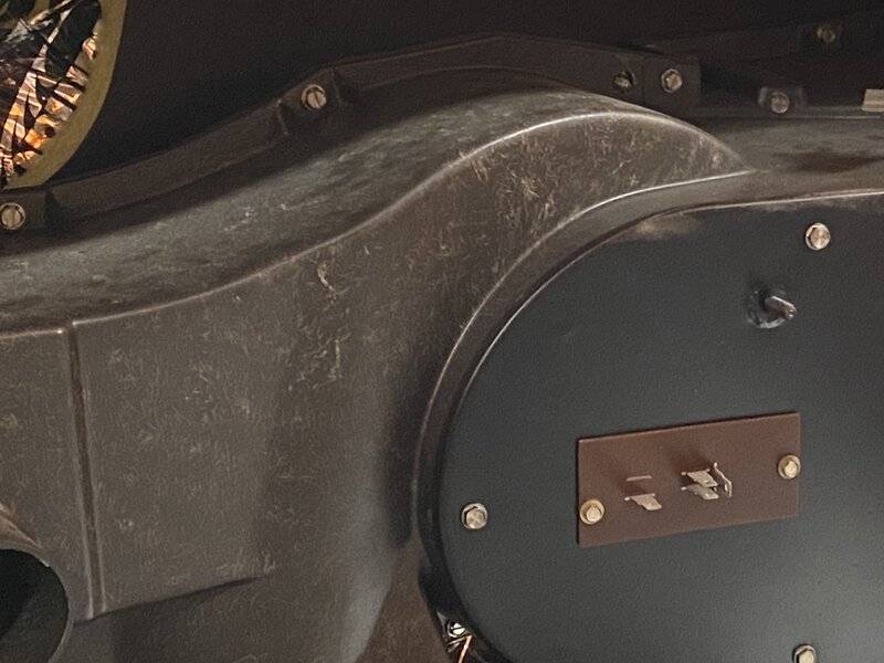

Is the heater box supposed to be a natural finish or painted? I glass beaded it and looking for the correct finish? I tried a clear satin on a test area and it brought out the natural fibreglass pretty nicely.

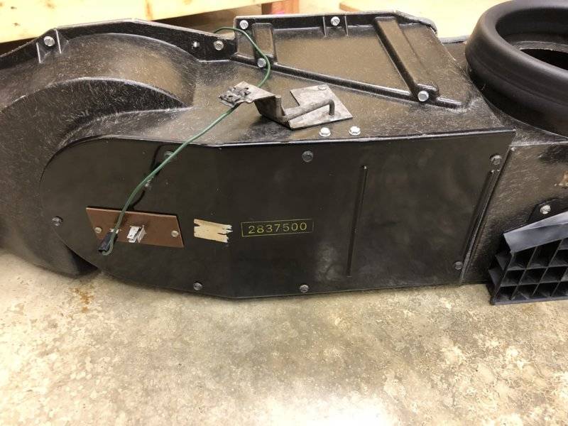

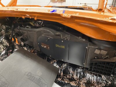

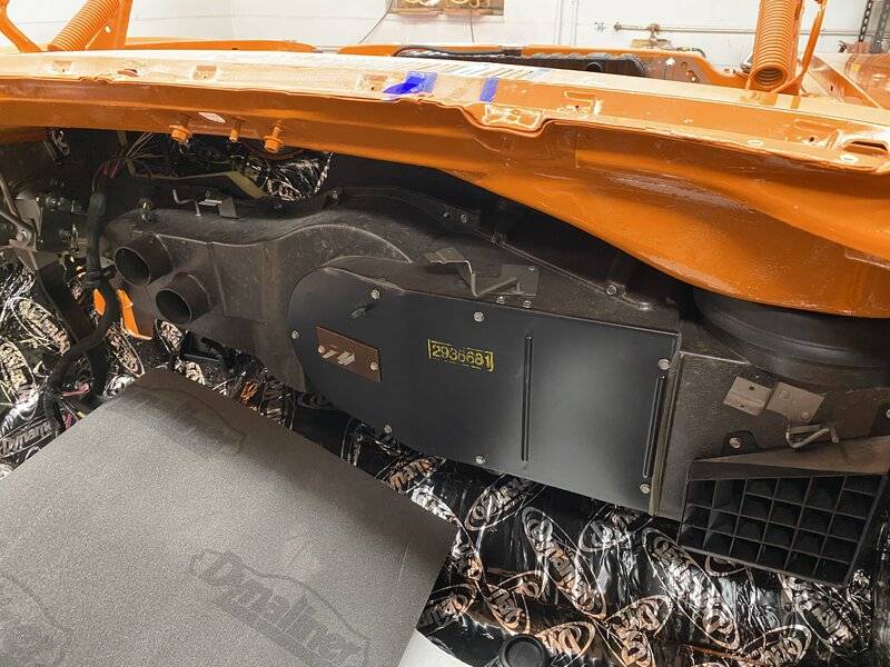

Satin black for the cover panel. You can buy the rubber stamp for part number on e-Bay if you want the numbers.

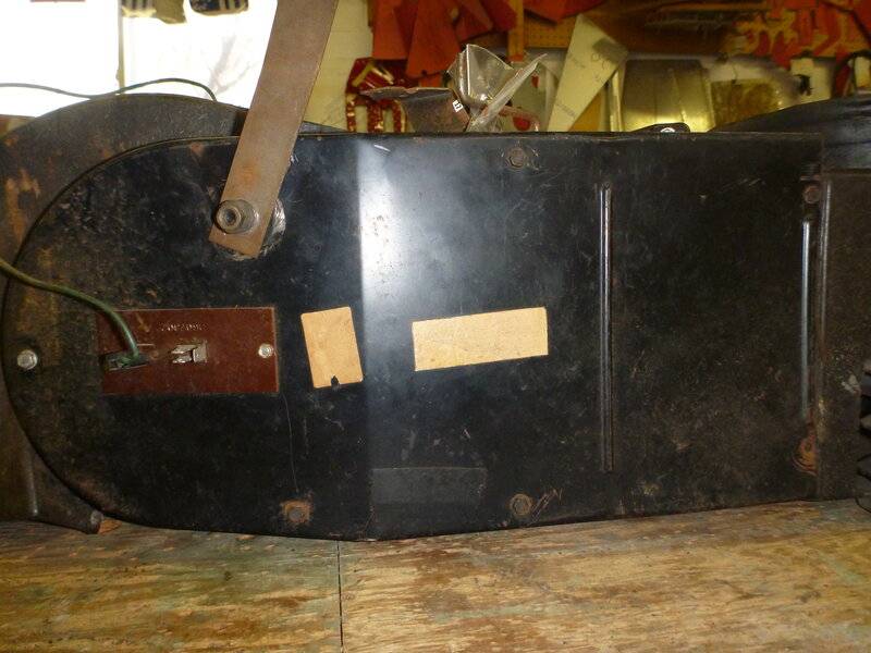

Mine had the same, two paper decals actually and everyone told me "that's not factory" so I stamped mine like everyone else. Then someone posted shots of the decals that came on theirs, about a year later. I'll have to see if I can find said shot. Here's mine before restoration..

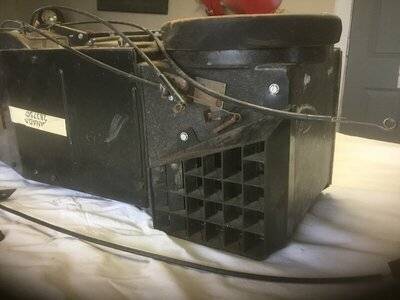

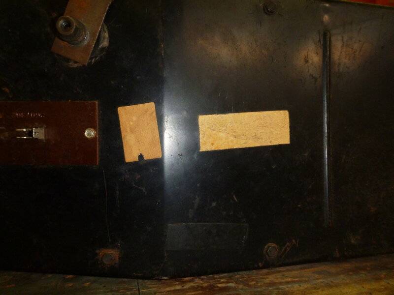

Found this one with both, it maybe the only one I have. I'll keep looking, although I'm not sure anyone actually came up with a clear one of what was on the label. Maybe someone ran out of yellow ink or lost their stamp! lol
I didn't see any trace of the yellow stamp on mine, but I was thinking the same thing...maybe it's a Canadian thing.
View attachment 961955 View attachment 961956
Do you know where I can get that decal or if it is even reproduced?
i am trying to find it but i think the paper decals is a Canadian thing.
