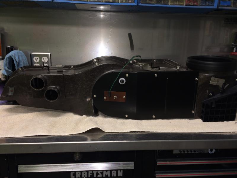

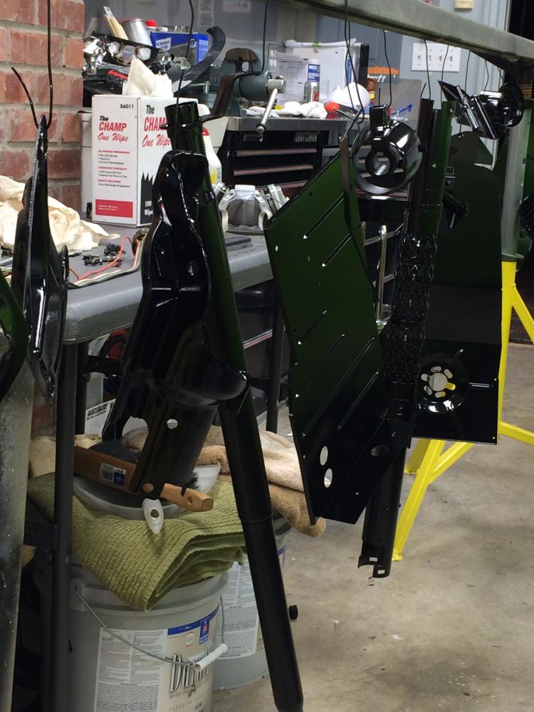

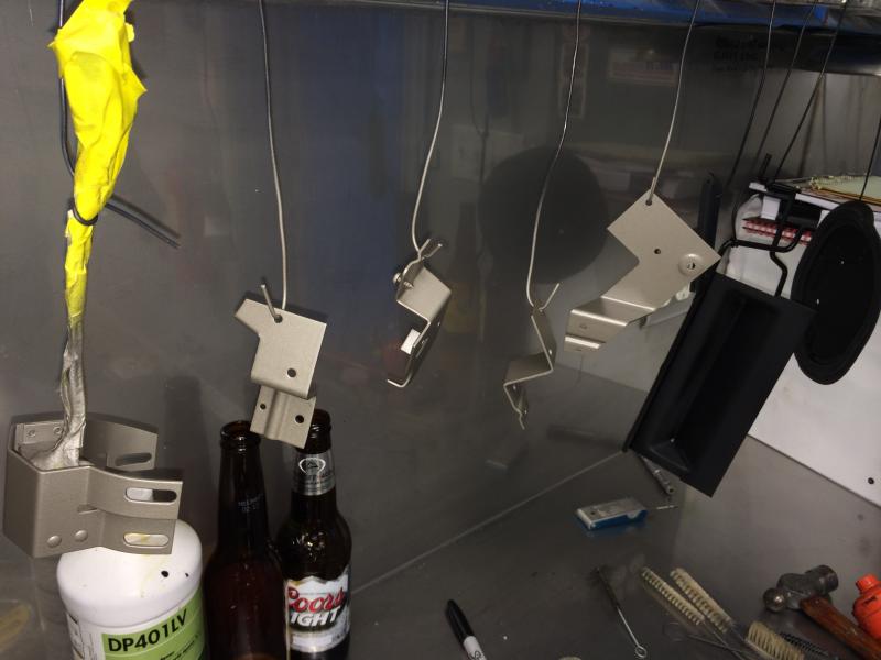

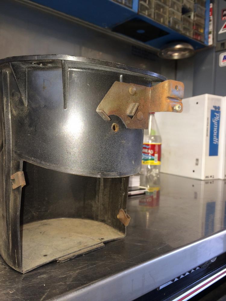

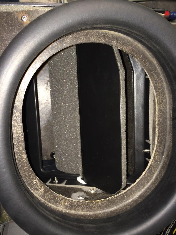

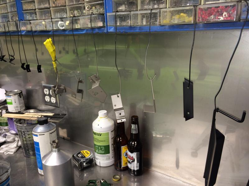

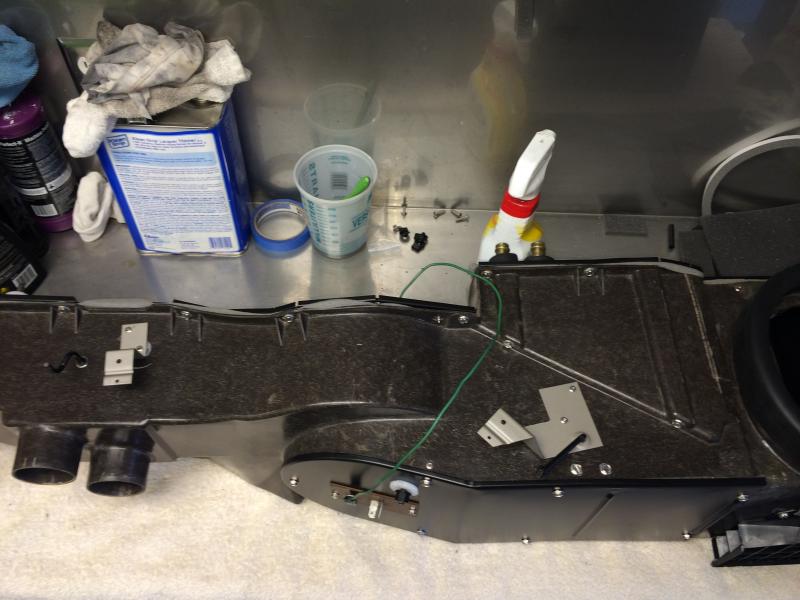

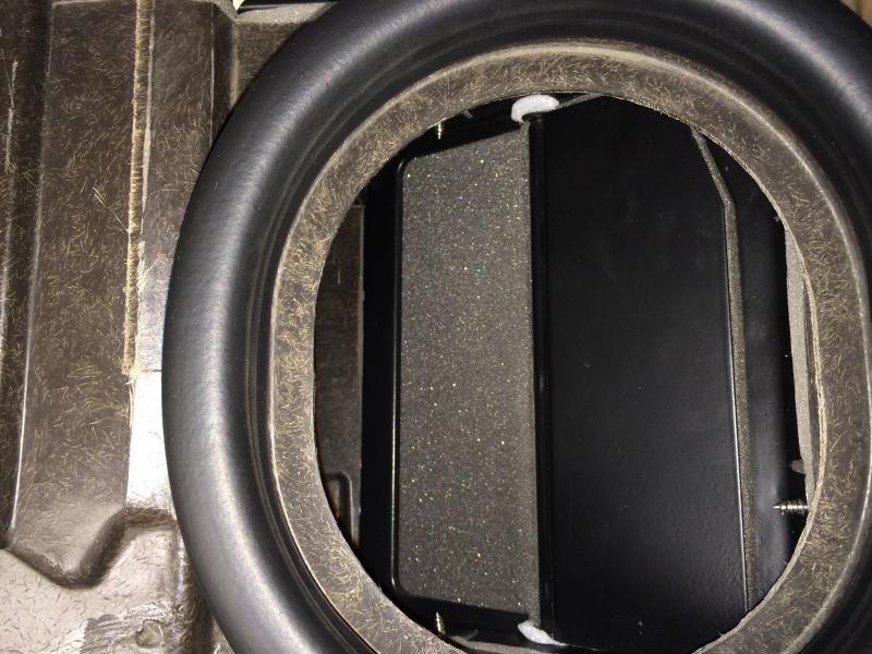

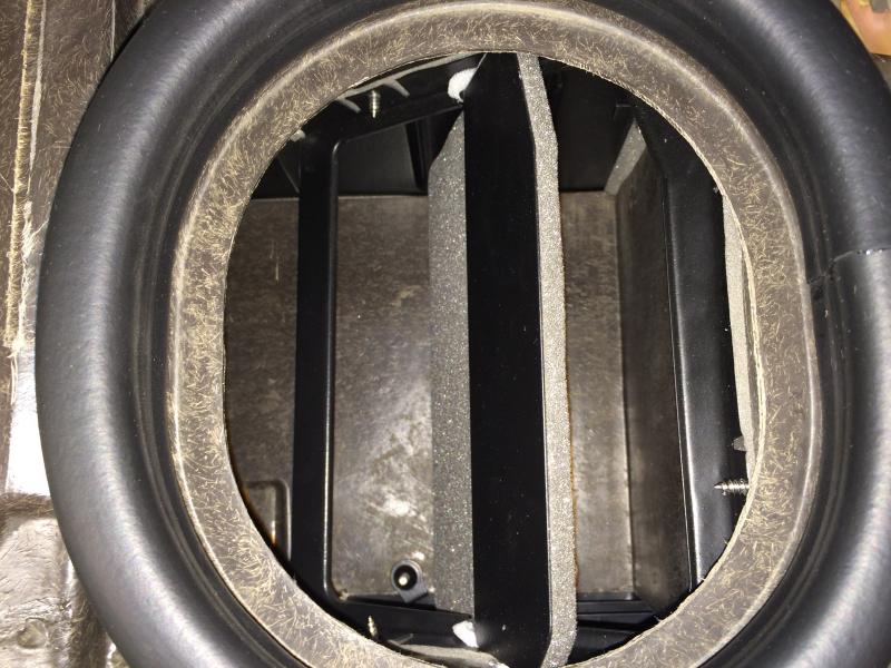

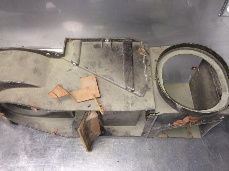

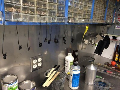

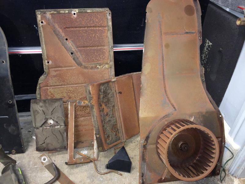

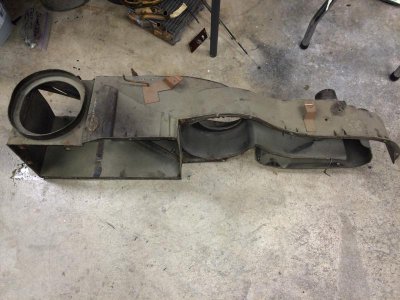

Decided to rebuild my heater box from my 68 Roadrunner. Bought a complete gasket set from DMT.
Man there's lots of small parts in the heater box.:icon_confused::icon_confused: I sand blasted,epoxy primed, and used detail grey from The East Wood Company or Low Sheen Sems Black.
Also pulled the fresh air box.

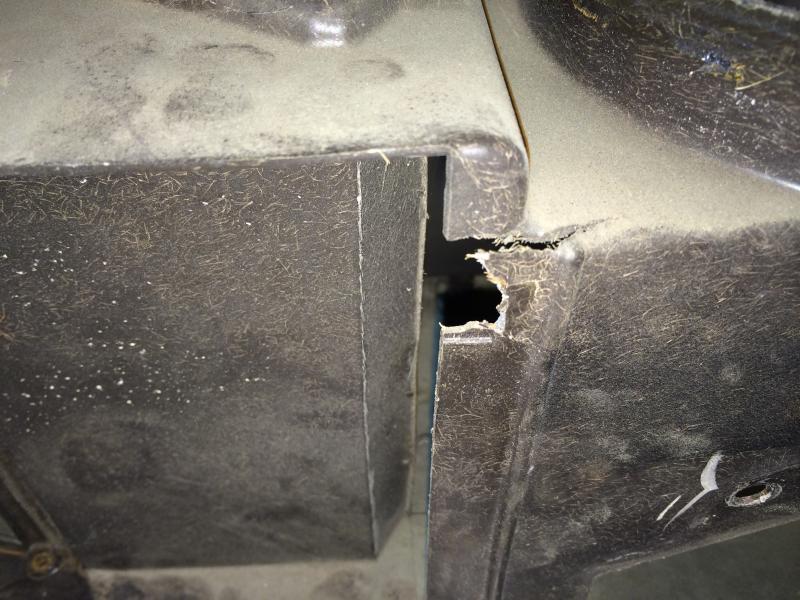

Ground it very carefully and used fiber glass resin and glass sheet. Made the repair small and it is on top edge of box up under the dash so I don't think you will be able to see it.
I will post picture of the fix soon.
If I do it again I would only apply the fiber glass and resin from the inside only so you don't see it. The repair is very strong.

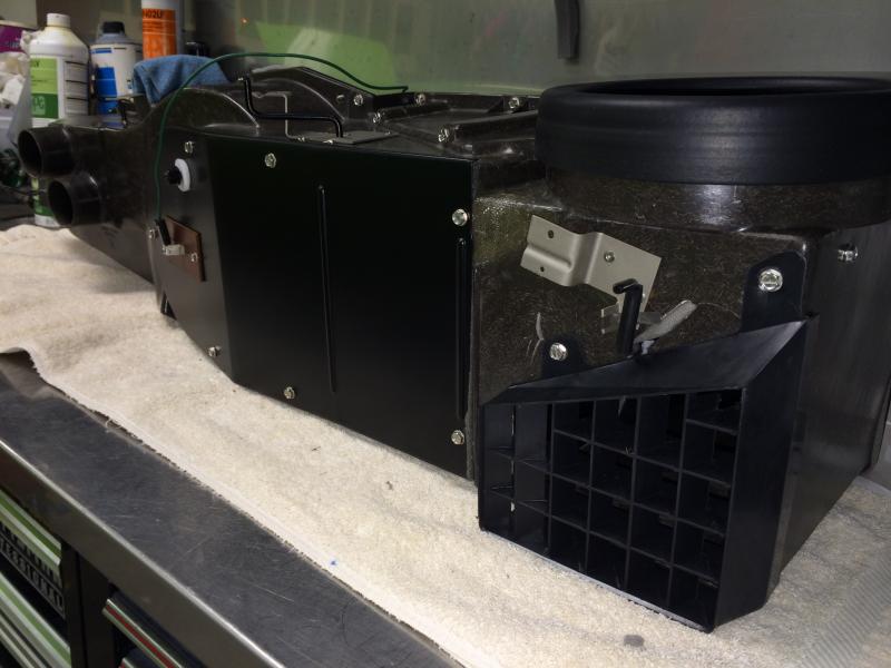

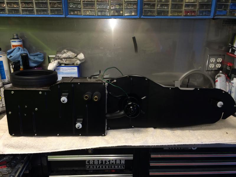

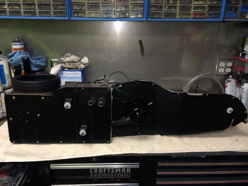

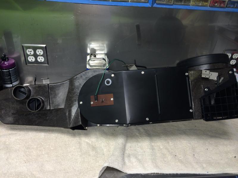

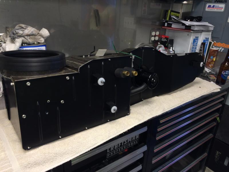

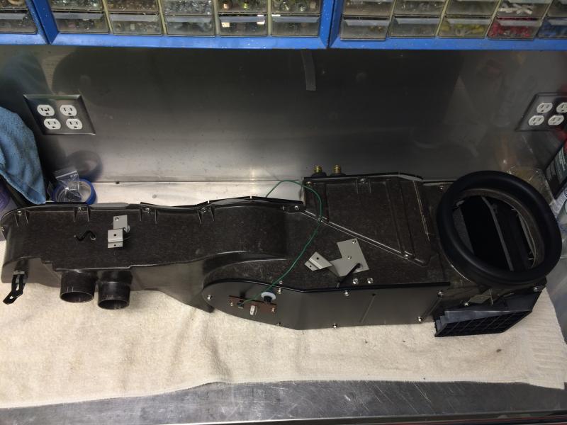

Oh man finally done with the heater box rebuild.
I think it turned out pretty good.
Thanks for the people that helped me along the way with my dumb questions!
You can see in one of the pictures the small fiber glass repair I did. It's towards the top and for the most part I don't think it will be very visible under the dash.

Top notch work there!!!! Brings back memories when I did mine!
Nice work !! It's a shame you are on the left coast. I have one that needs exactly your touch.
Nice job. I did the exact same thing to mine this past winter. DMT makes a nice kit.
