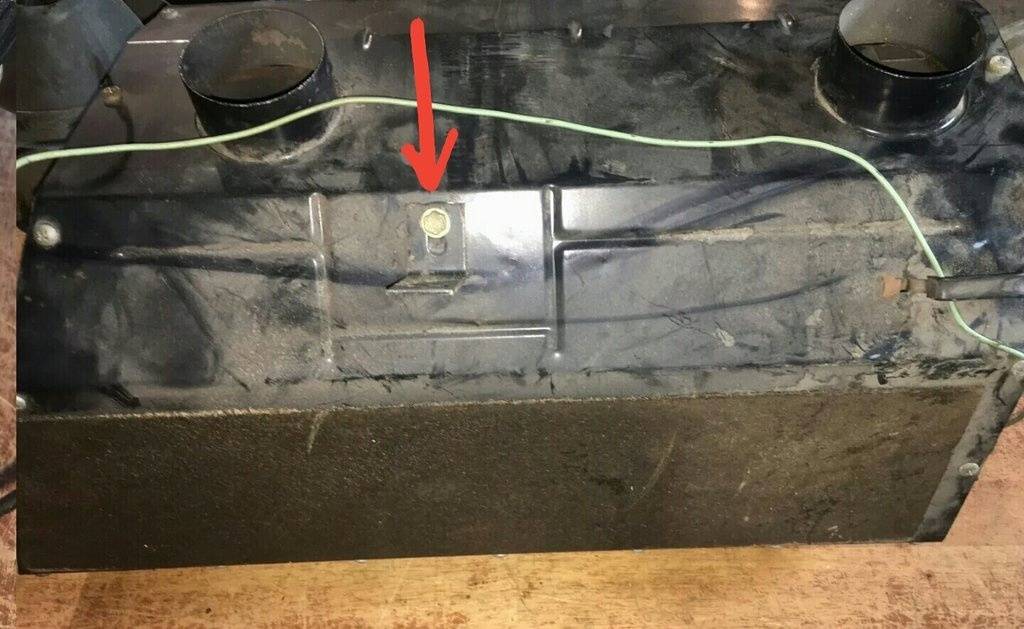

There might be a bracket between the box and dash.
Can't say for sure about a '62, but the '63, '64, and '65s have a bracket on top.

That's what it was, thanks it's out and now I need to rebult it. Looks like I need a heater control valve for a starter. Any one got a good one for sale or where to get one.
