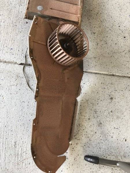

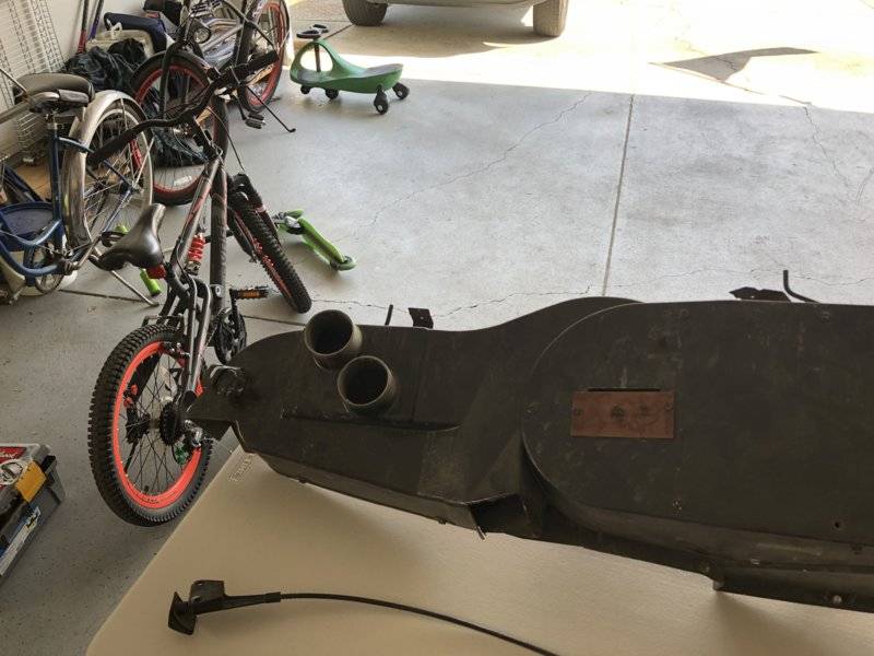

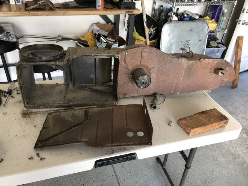

Welp I had an extra box that could use some love. So I decided to clean her up and off her when I’m done. Got the DMT kit and a new core. She will be brand new!

Do I see correctly that it only takes like (3) nuts removed on the outside of the firewall for the whole box to come out?
On an a/c style its 5.
On a non a/c IDK.
It helps to have the seat(s) removed.
That is correct (at least for 69 b body non a/c). Three nuts hold it in place on the firewall.
