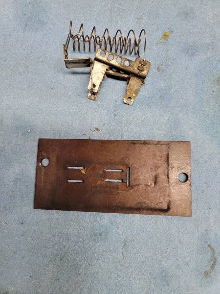

Is this heaterbox thermostat available anywhere? I am going to epoxy the phenolic board back together, pretty sure that I can salvage it. Just wondering if it's available.
'69 RR, non A/C.
Looking like the blower motor resistor. O'Reilly's should have one on the shelf.
Agreed Bill, it's not a thermostat it's just the low / medium speed resistors.
Okay, thanks guys! Part of the center in the phenolic is broken. Didn't want to use JB Weld with metal in it, thought it may conduit energy. So I will just pretty much waste 1 pump of epoxy resin, will mix a little flox in it for strength, should hold that resister better. Thank you again.
Got mine back to usable. Went to O' Reilly , the guy couldn't come up with it, no modern application. He did find them on E bay.
