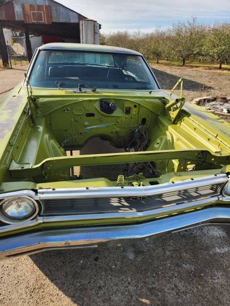

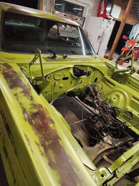

I am missing everything for this car to have heat, box, core, controls. I have nothing in it. I was told it's an AC car and that a regular heater box won't work, is this true? Bottom line I don't care about A/C, but I will need heat on my glass if I plan to drive it in the morning.

You’re right that the boxes don’t interchange, the firewalls are different between A/C and non A/C.

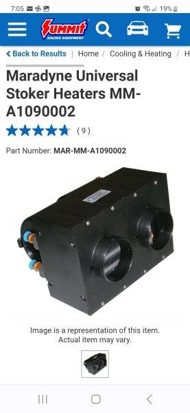

The A/C boxes are difficult and expensive to restore. I would just go with an aftermarket hot rod heater until I could deal with the time and expense of putting it back to original. There were 43 results when I searched “heater” on Summit.
A/C firewall will have a large round hole for the blower motor that will have to be plugged.
And another hole for the a/c lines…
AC boxes are not hard to restore and are generally available. Yes, there is a lot to them and some expensive parts but to me worth it in the long run. Plus it fills those nasty holes in the firewall.

Could a guy just unch 2 heater hose holes?
Maybe some mounting stud holes..

The cost on the core is not bad, I'm still on the hunt for the right parts but I'm not above building my own electric heater and plum it to the vents.
I think I go with this, move and mount the switches, build a bracket to mount under the dash add a waste gate to shut off flow for summer. Connect to existing vents call it a day.
