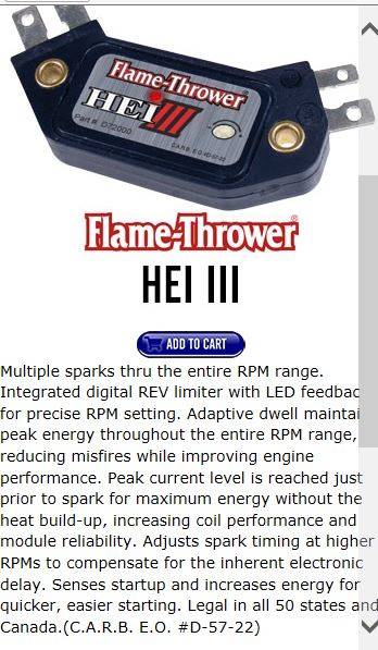

I was looking this one with rev-limiter.
Edit: Picture.
Did not show up went to a blank order page. Think that is the III you are talking about. They work great. Gets rid of the box and ballast resistor also. Thy wires right to the coil. I believe you set the rev limiter to your max and you are good to go. Uses the stock coil and wires.
Should've known cart would be blank after leaving site. Should snipped picture in the first place.
Just got off the phone with Pertronix, they don't have a ignitor 111 to convert the Chrysler electronic distributor to use it, I was looking at the 71381A and the 71385 but according to the tech they wont work. They do have a Igniter 11 kit. Really don't want to spend $300 + for the HEI distributor but might have to.
