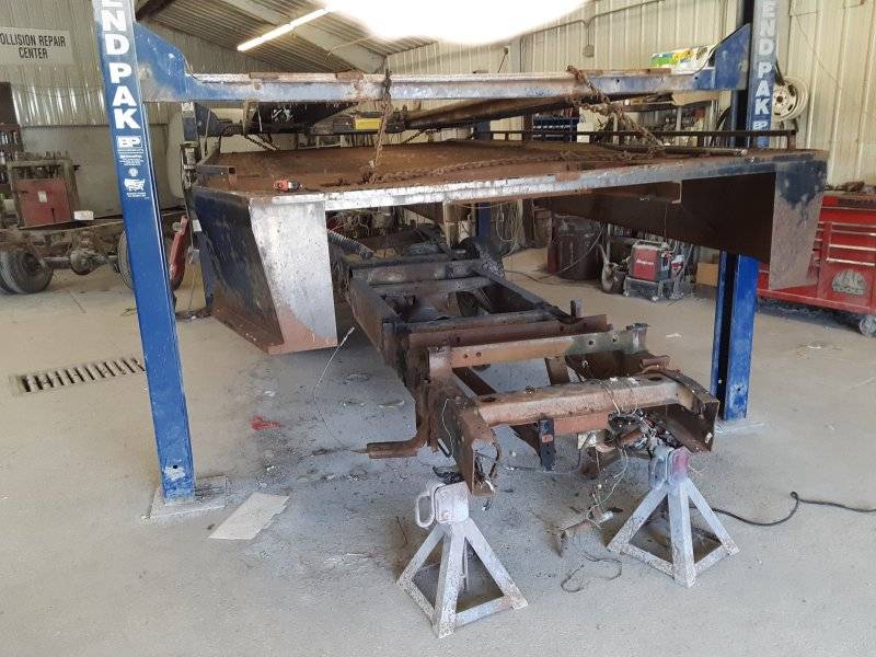

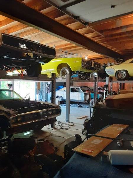

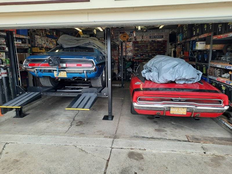

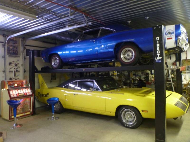

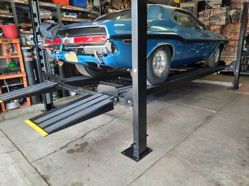

12 foot is the minimum to be able to use the lift comfortably at full height. The city told me my building could not be higher than 24 feet tall in the residential area. My building is 23 foot 11 inches tall with 12 foot ceiling on the first floor. The last picture is my asymmetrical work lift. All the other ones are storage lifts.
If you are building, don't even consider minimum. You have a clean slate. 12' plus.

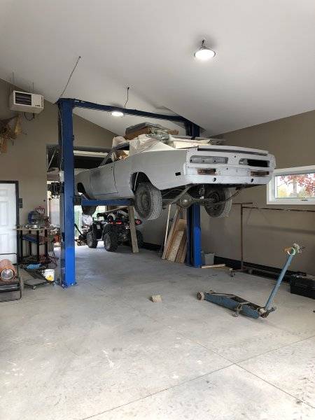

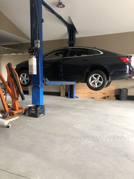

I did 10’ with scissor trusses. Roof ridge is left to right where the doors are. Center is 14’. No attic when you do it this way but it doesn’t look like a tall building either.

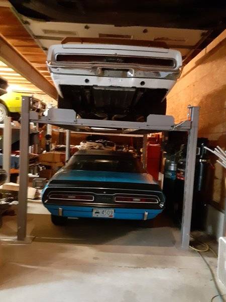

My new shop i put vaulted ceilings in and 10 ft walls.Total height is about 10ft 8 in. I placed my lift in between the rafters to get the 144 inches i needed.

I have 10'2" and can store one B body over top the other, very carefully. I was limited by local building height restrictions when I built so a lot of thought had to go into the design. It works out well for me and I am able to work under the car when needed.

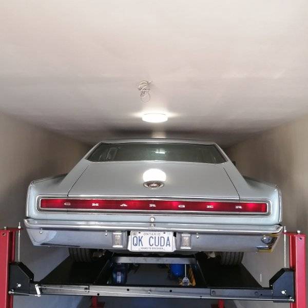

I have 11’-8” in the area I work in. That’s high enough for my cars and to put the wife’s Edge on the lift to change oil and rotate the tires.
