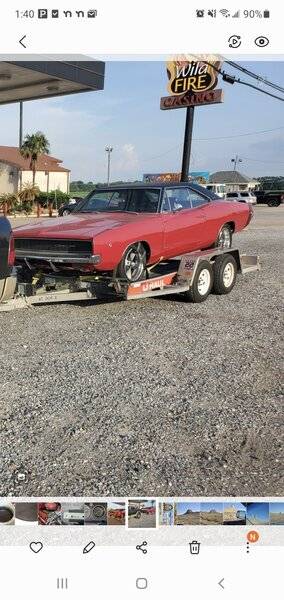

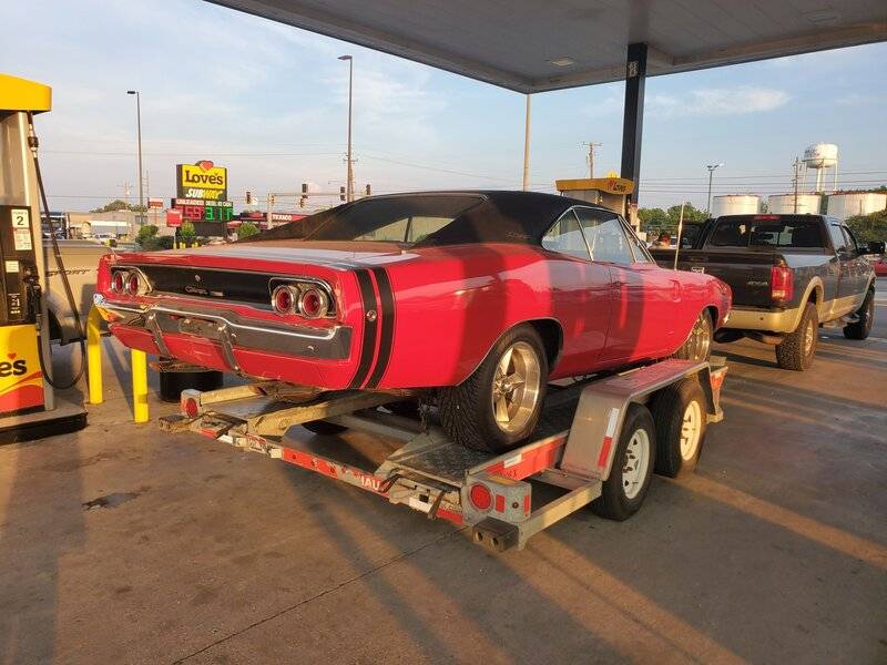

Only have a couple pics of the charger:

Only have a couple pics of the charger:View attachment 1182365 View attachment 1182366
