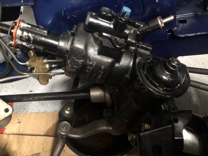

New to this site....so allow me to introduce myself, I am a professional aircraft mechanic that is in the middle of rebuilding a 1968 Coronet, RT 440. All that means is I am mechanically inclined, I will need assistance from experienced auto mechanics. Right now I am installing a Wilwood master cylinder with a southwest speed booster. All and all nice stuff. A couple questions: is it ok to install the vacuum port at the 5 O'clock position rather than the 11? I would like to keep the hose routing as clean as possible. Second, can this system be operated with disk on the front and drum on the back for now....I plan on upgrading to all disk....but money does talk, even when you don't have it. With the kit came a bracket set for the peddles. I quickly learned that with a 883 four speed the bracket kit is worthless, the OEM is much larger. I ended up shorting the push rod by about a half an inch to accommodate the OEM set up. Additionally, I have a lot of slop in the steering and I cannot find a steering box overhaul kit that is more than just o-rings. I would like to replace the worm gear and the piston. But I will also need tools for this, any advice on this issue would be most welcome.

Is it power or manual steering and do you have a pic of the box you have.
It’s power steering. Let me know if the photos are good enough. Thanks.
Two dogs I have one like that it off my 64 you are welcome to it. I have no idea what shape it's in. I changed to manual but again I don't know anything about it.

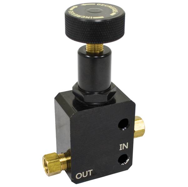

You may want to get a rear brake adjustable valve, otherwise you may have too much pressure to the rear brakes causing them to lock.
