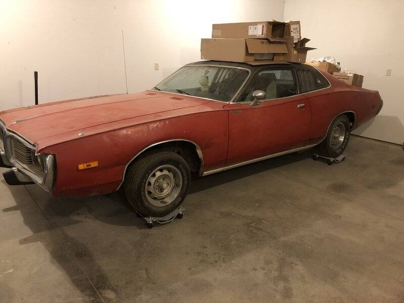

I forgot to post a picture of the car. Sorry it looks like a mess, but it is a good shelf to store the parts on until I am ready to work on it. It is in definite need of body work, but that is phase 2 or 3. Phase 1 is to get it running and put back on the road.
That’s a great start if i had a front bumper ld be buffing on that car red
